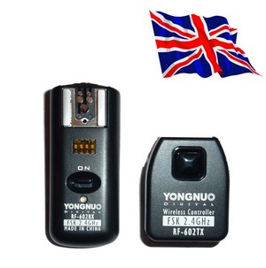

New Radio Triggers
they look pretty sweet actually, wouldn't mind getting my mits on a set myself :D
I don't have any experience with them though I'm afraid :(
No-one does, those pics belong to the manufacturer, but from what I can glean it's Nikon-only atm and has got basic ttl (so no CLS functions) and is projected to retail at around the £100 mark for a Tx/Rx set.
Doesn't that Flickr page say they support iTTL - so CLS will work?

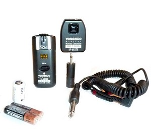

I got one of this type and work great and only £28.99 got mine next day in post
Will work as a Flash or Shutter remote

They look good, a cheaper (and less bulky) alternative to pocket wizards.
Meanwhile, Pocket Wizard have just released a beta firmware update for their Canon E-TTL system here http://www.pocketwizard.com/upload/photos/677Beta_Firmware_Overview.pdf
It does some very clever things, but doesn't seem to address their range RF interference problem which is I think related to the frequency they use, ie much lower than most others. Kind of a fundamental problem when the only reason to buy the things in the first place is to get more reliable range :shrug:
