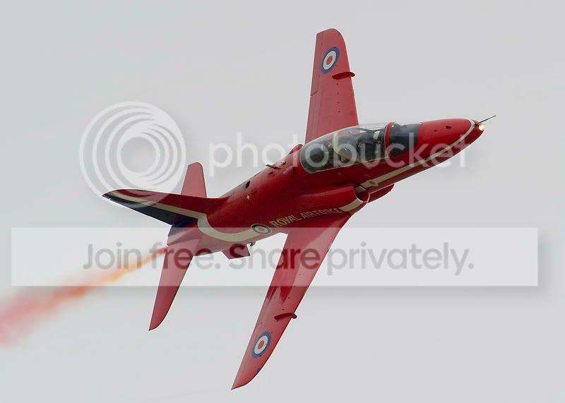

Just wanted to show an example shot of my new converter on the 300mm
2.8.
So this is handheld 600mm f11. The weather was grey and bland. I don't think it did too bad. Certainly better than the old 2 x converter. :)

Does that combo have enough resolution to be provide the higher pixel density of the D300 to work well or would the 300 + 1.4x work better on the D300?
Andy
It would work great on the D300. If I get chance this Friday, I'll try it for you. I have all 3 converters and this new one has left me stunned.

I think if you can get a good TC that doesn't add anything nasty (lateral CA, fringing or additional resolution degradation), it comes down to how much resolution you have in reserve in the original lens. Certainly on this evidence, it looks good. I can happily shoot wide open with my 300/2.8 with the 1.4x TC with no obvious degradation at a 100% crop. With the 2x TC I would normally stop it down to f3.5 (f7.1 overall) and the results are almost as good. That's 1200mm of equivalent reach!

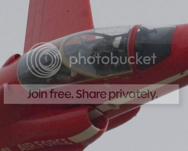

This one is at f6.3 overall with the 2x TC and cropped to 100%: http://picasaweb.google.co.uk/ellio...untryPark27thNovember2009#5410679719195872530 (so only stopped down 1/3 stop)

I'd like to see a side-by-side comparions with the TC-20E II and the 20E III.
A Nikon 300mm f/2.8 is going to be good with a 2x TC, as its a damn good lens, with resolution in spades. I've got some very sharp ones with the 20E II and the 300mm f/2.8 VR.
I think this TC is designed to help with CA and corner performance, but I'm not convinced that if it was shot side-by-side against the older one, there would be much difference in center performance.
Need to see a vs b blind tests to see if this is worth £400 vs the older one I think.
Crop looks a bit ugly with nasty noisy patterns in the red, so with resolution being lost by noise and motion blur, we can't really tell.
Agreed - a static subject is a better comparison, but it's nice to see it being used in a real situation too rather than a test chart!
