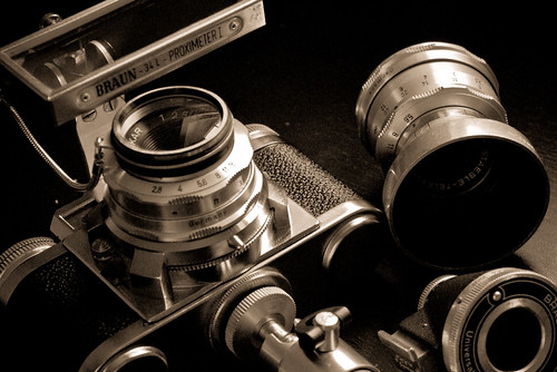

The seller is Austrian and couldn't really help me out, they mentioned it was a close up device but I don't know what the square window bit is and how it all fits together, and what lens it should be used with (I have a 45mm, 85mm and 135mm)

The rectangular bit should clip over the viewfinder.

Don't think the one you're looking at clips together. The 'filter' will just screw onto the lens and the rectangular magnifier will screw or clip onto the camera body.

I think I have worked out how this all works. The fork shaped part will slide into the accessory shoe. The square window then clips onto the metal spike that will protrude from the front of the accessory shoe, and the filter screws over the lens.

I'd suspect the rectangular magnifier will have a lip that goes under the viewvinder with the black bit folding over the top plate -- the screw would then tighten to clap it to the camera.
The spike has a couple of click stop relief bits, these will be for different mags... whether thats for different lenses or not I don't know. the square bit is not so much to show the mag in the vf as to allow for the parallax, much like the Voigtlander Proxirect system (from "proximity") though that uses a couple of inverted prisms in the viewfinder path to allow variable tuning from *real* close up to about 30 inches.

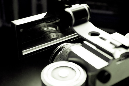

Well, it's here - it seems to fit and looks right when I look through the viewfinder - this is how I have it fitted, what do you think?
I'm a little surprised how far out the viewfinder maginifier sits, but glad to hear it all went together.
