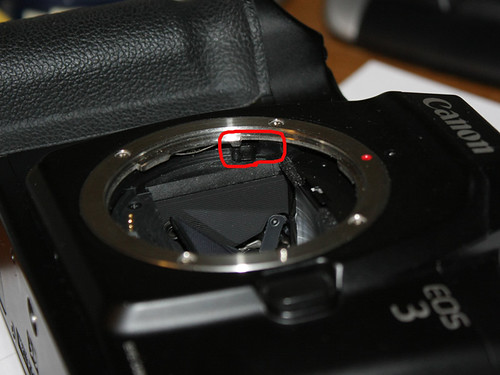

Yep - i've got an idea. There's a switch built into the mount for the lens
Some adaptors need the switch to be held open, some need it to be left closed. If you're getting the error, then your adaptor needs it held open. Take a small piece of film canister material and a pair of tweezers and wedge the switch open.
It's all down to the length of one of the bayonet tang's in the adaptor. I've 2 adaptors, one of them had no AF confirm chip fitted and needed the switch wedging open. The other had an AF chip and the tang was longer and held the switch open itself
(ignore the remove metal from this end bit - it was instruction for someone else's badly designed adaptor!)
Cheers TBY. I cannot find the adapter at the moment but if I fire it with no lens on its fine, if I wedge the little switch open with no lens and try I get the same 'bc' error, so once I find my adapter I'll get the files out and let you know how I fare :)
to check if you need to get the dremel out, attach the lens to the adaptor, and put the adaptor on the camera but don't fasten it all the way closed (i.e. it doesn't click into place.) Support the lens in place, and do a test fire of the shutter. If it works, then just take a little off the adaptor tang where it's marked blue and in the green circle. Obviously, it's also essential to get the adaptor scrupilously clean afterwards - especially if you're going to use it on the digital as well - don't want swarf in your sensor - or indeed anywhere else. I used a spray can of electrical contact cleaner to ensure that nothing untoward was left behind after working on it.
trimmed it back but it appears the problem is the EMF AF confirm chip as well! taped over that and all is good so I just need a dumb M42>EOS adapter for this camera.
