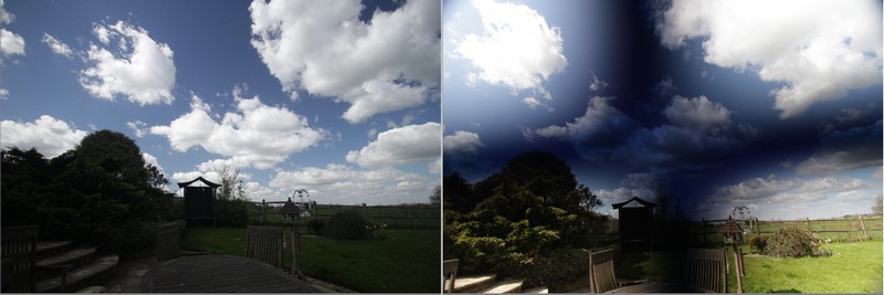

I've never seen a cross-pattern interference with a variable ND, usually it's two extremely dark parallel bands, sometimes slightly curved. Are you using a CPL/LPL, CPL/CPL or LPL/LPL variable filter?
I use a DIY variable ND and with the ability to rotate the circular and linear indepenently (which I don't think you'll get with the 7DS version) I've been able to experiment with the orientations of the filters relative to the scene and each other. From my own experience with variable ND filters, the uneveness of the effect at short focal lengths and maximum filtering is most easily described as being very similar to the banding issues you'll see using a polarising filter for a sky shot with an UWA. It's not exactly the same, it's down the interference between the two polarisers and it's constant for a fixed orientation of the filters regardless of your orientation to the sun. The effect is more pronounced with a shorter focal length (I tend to stick in the 30-50mm range).
Parkmoy.. using these filters is slightly a*** about t**. You don't need to know the strength of the effect. Pick the exposure you want (shutter speed, aperture and ISO) and then adjust the *filter* until the metering comes right. In full sun I've found it best to stick around 2-5 seconds on the exposure to avoid any unevenness.
Because you're using two polarisers, for double the trouble and then some..
OK, I've just been out and took two shots, one with the CPL and t'other with the VND.
Both are taken pointng 90º away from the Sun - where the polarising effect should be maximised. The cross-pattern is the same regardless of the direction.
As you can see, the cross-pattern makes this shot unusable.
Odd, I've never had an effect like that with a VND. I only ever get banding (on opposed corners/edges) when I push the effect too hard and it's noticable worse on wider lenses.
I know I'm using lens-CPL-LPL when I'm shooting VND, I wonder if some of the off-the-shelf units are using CPL-CPL or LPl-LPL? (both of which are cautioned against when DIYing a VND).
