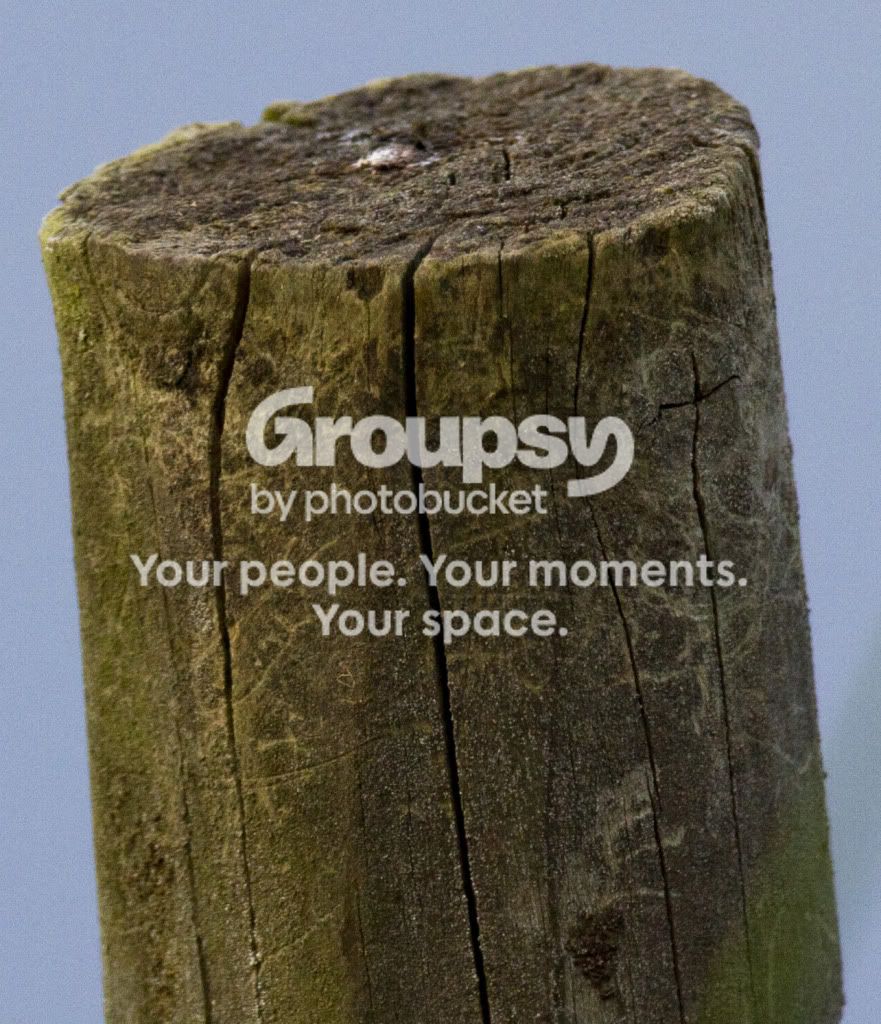

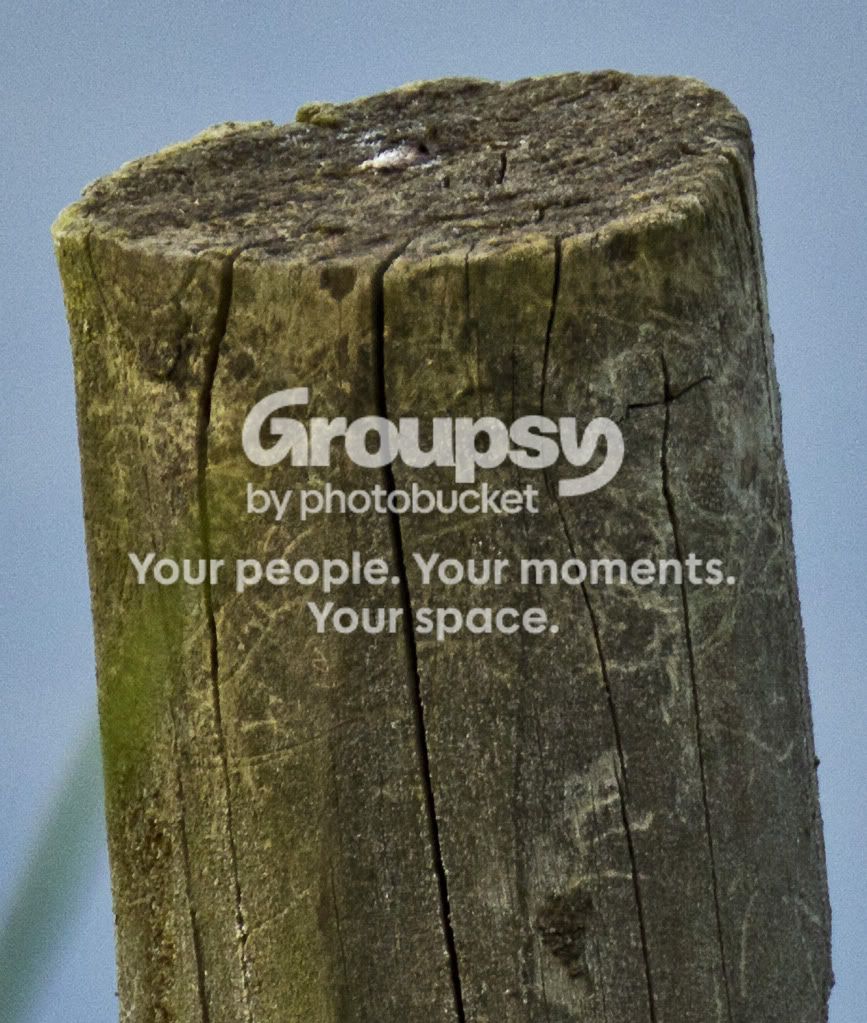

1. Sigma 120-300mm at 600mm f5.6 (kenko 2x DG)
2. Canon 500mm at 700mm f5.6 (Canon 1.4x II)
3. Canon 800mm at 5.6
Center and corner crops
I'll take the Canon please ;) What's it like at the edges?
Have a look at the full frame link above (lower right side). Not bad at all IMHO.
Very happy from the first few shots but have a lot more testing to do!
Well assuming that the scarf is actually in sharp focus (it looks close!) the Sigma looks terrible. As you would expect with all those telecons on it.
As shown on the full crops, the focus is on the nose and also on the 'paw' on the lower right side, which is not looking not bad at all to me.
Actually, considering the two teleconverters, the Sigma is surprisingly sharp, and much sharper than the Canon 200mm f2 when combined with the same 2 teleconverters (more photos to follow!)
Mate, that is a zoom lens with stacked teleconverters, compared at a longer focal length to a lens 5 times its price. That's not bad at all!
They look a lot better than the first set you put up of the teddy, with the extra extender.
But the subject is a bit artificial and you can't add sharpening and contrast like that to a normal, naturally-toned subject.
Would like to see something more real :)
AF with the 2x is slower but very accurate.
Will take images of different subjects tomorrow but it will only be with the 120-300 + 2x.
No more comparisons with other lenses for a while, too time consuming!
Comparisons are the best way of seeing how good it is ;)

Below some shots with the Canon 2x III and also a comparison between the Canon 800mm and an up-sized crop of the Sigma at 600mm (wooden pole).
The pole is 100% crop and the rest approximately 50% crops.

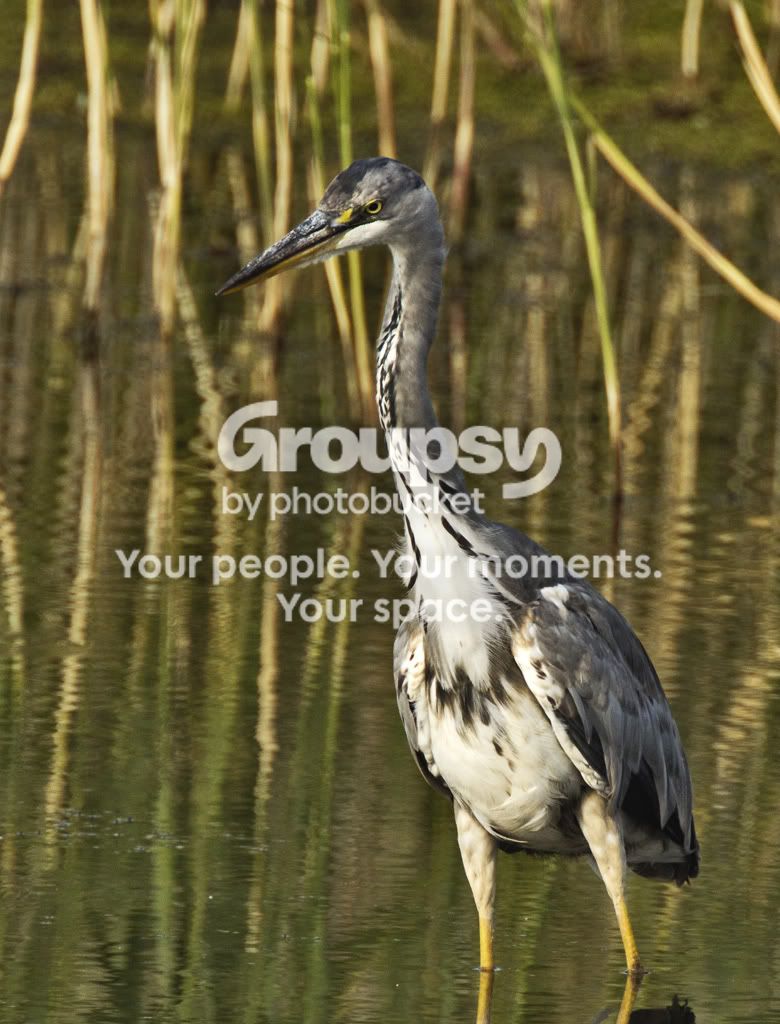

Still very happy. Used it for shooting gannets and got some nice shots. Will post when back from holiday. Very impressed with low light AF, minimal hunting.
