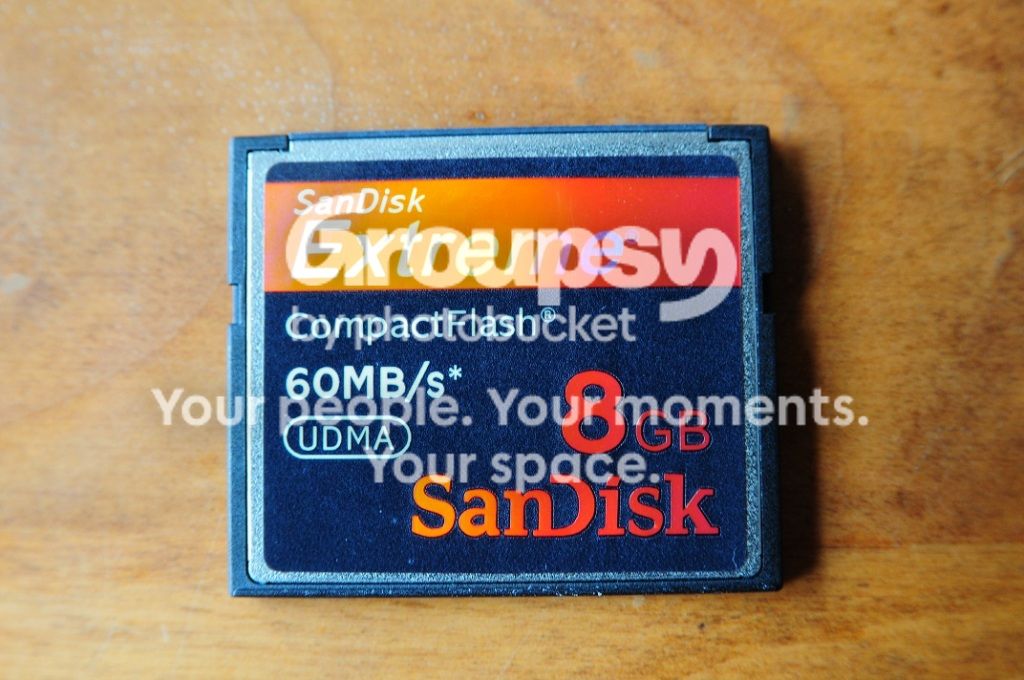

I recently purchased an Sandisk Extreme 8gb card from that well-known auction site and I'm concerned the product may not be genuine so I'm hoping for some help before I approach the seller. It wasn't hugely cheap and the sellers feedback is good, so I want to be certain I'm right before accusing anybody.
There are a number of reasons why I don't believe it's genuine as explained below:

This immediately started alarm bells ringing, so I looked a little closer at the card. Other things I noticed...

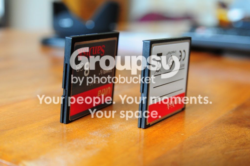

2) The 'front' label is on the reverse side compared to my other Sandisk card. So the front label is face down when I insert it into the camera as shown below...

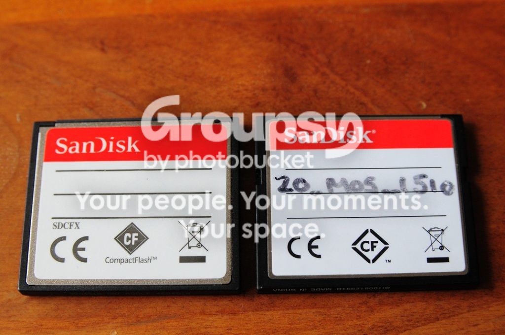

3) The front label isn't stuck on straight...
4) The rear label is missing the ® from the Sandisk logo, 'Extreme' card on left...

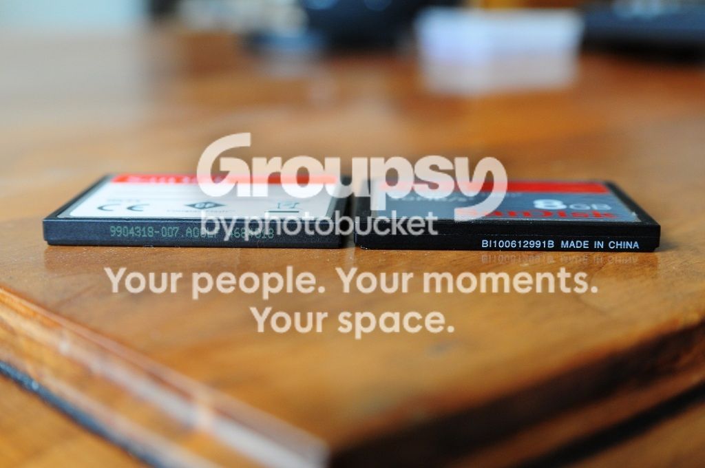

I've included the below shot just for reference, I'm not sure whether the Extreme card should have the 'made in china' text like the Ultra card...

Unfortunately I'd say that all things add up to a fake card; speed, incorrect part number, labels on wrong faces and also the logo on the rear label is very poorly printed, which is not conclusive by itself but given all the other anomalies would suggest it is fake.

Looks like you already have enough info but in case it helps - I got a SanDisk Extreme 8GB yesterday (from Amazon) and mine looks like your SanDisk Ultra card in terms of the lables and 'Made in China' text etc
