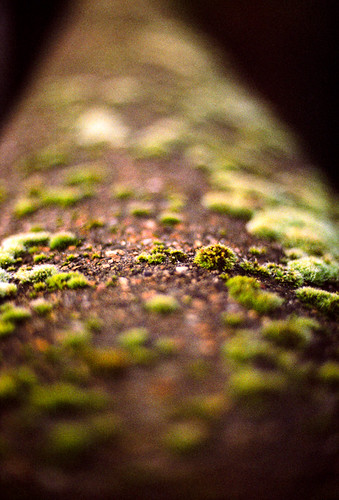

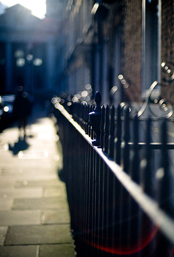

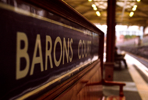

Well here's a few results ( will post some more in a bit).
Shot them handheld in "Auto" mode through the OM10 set at 1600 iso
The originals are exactly as they've come out of the scanner.
The retouches are simply an add of some contrast to account for the scan and the cross processing.
As they are simply test/experiment shots, I've not bothered with reframing, dust removal etc.
I don't think they're bad for a 3 stop push tbh...what do you guys reckon?

6. Original F/4 1/30
Retouched
7. Original F/4 1/60
Retouched
And this last one was actually the first shot I took not realising the aperture was stopped down at F/22.....shutter stayed open for approx 1 full second...quite impressed at my andholding skills tbh:D
Original
Retouched
