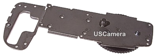

The thumbscrew gearing on my Canon BG-E2N has broken (it will not screw on to my camera) :(:(:(:(:(:(:(
Has anyone got an idea about repair cost.
Are battery grips something that can be repaired?
Can it be dismantled easily? If so, might be worth having a wee look, it's probably a 2-second repair....
I don't have to tools (a tiny weeny screwdriver) and believe it's a plastic gear that has broken.
I phone Canon in the morning but just asked if anyone had an idea.
Really **** off as it's the first time I've removed it in months Just wish I'd left it now :(
Nikon ones are easily repaired and if my memory is correct canon are the same principal the screw you twist has a toothed (plasic) inner bit that turns the actual screw that fixes to the tripod mount so looks like this is all you may need to replace on it the teeth do wear

Well I've had it apart and I cant do the job myself, nor could I if a bought the replacement bit from the USA.
I did this at work so no photos.
After removing the top cover, I found the top plate assembly as below
I gently looked under this and found there is no access to the actual gears as they are enclosed in the assembly by a metal riveted holder.
The big problem for me would be that the wiring (a very thin ribbon and a few lose wires runs through the hole in the assembly. These wire look to be soldered on at BOTH ends. which would make it a skill job IMHO to get them off and thread through a new top plate. A design clearly made to stop user repair.

Have looked around the web it looks to be a common problem with the BG-E2 grip, at least I could get mine off the body, unlike other who have had to hacksaw it off.
Have you read about the attachment problem on some of the early BG-E2
grips not seating properly? It would appear a lot of people who had this problem overtightened the screw and stripped the gears.
Obviously dosn't help you now but when you get the repaired one back it might be worthwhile checking the fit. Maybe speak to Lehmans about it !
