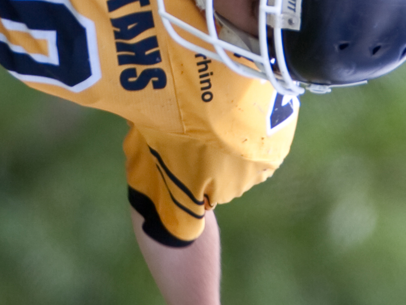

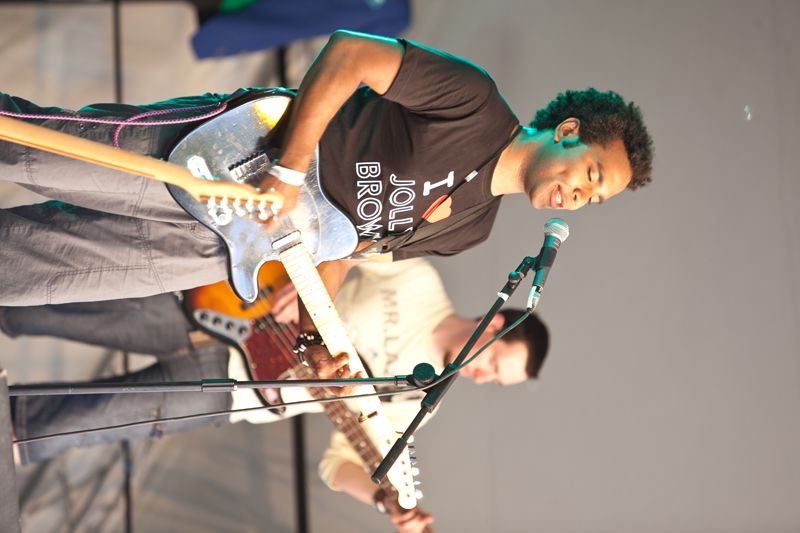

I'm wondering what the problem is with my 5D MkII.
I've noticed recently there seems to be an awful lot of noise on my images. Given that the Noise is supposed to be quite good on the 5D MkII up to reasonable levels what do you think about these shots....
They are both taken on ISO 100, no manipulation, just saved out RAW file from Lightroom.
1st shot is an 800px reduction saved at quality 60 in Photoshop, second shot is a 100% crop from the original image...
There seems to be lots of noise in these images. I'm having to run everything through Noiseware.
All my shots appear to be the same quality.
Do you think there is a problem with the camera as I'm sure at ISO 100 I should be getting crisp & clear shots, could there be a problem with the sensor?
What do people think?
The first image was at iso 125 f/4 1/1600 and looks underexposed, which would explain where the noise is coming from...
^^^ Have to agree. From what you've shown, they're about two stops under :eek:

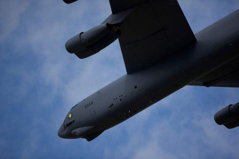

another....
what are your shots like on your 70-200? I do not get these issues on my 5DMKII - have done all the firmware updates? What version of LR are you using? Try processing one using DPP... worth a try?

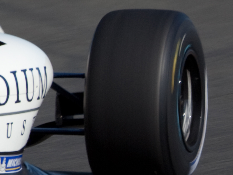

Hmm... I'm not getting it. I'm not sure I'm looking at noise. At 600mm you have to factor in the air quality between you and the subject. Even at 300mm I've noticed issues simply because the subject is simply so far away with a lot of dirty air in between.
And try as I can, I simply can't see what's wrong with the 24-105 shot.

I am unable to see the EXIF data on the photos, but wonder if what you are seeing is the extent of the DOF being applied?

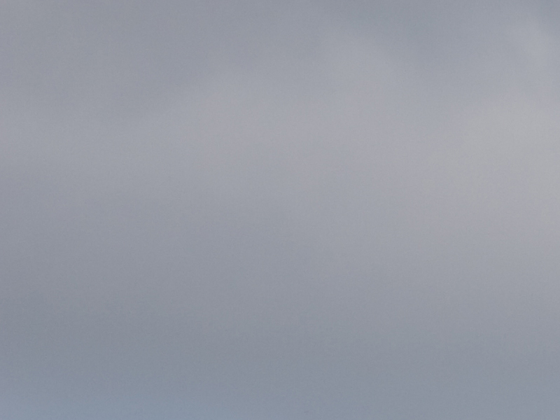

It took me a little while to see a problem to be honest but once I saw it I did not see it as 'noise' but as posterization. http://en.wikipedia.org/wiki/Posterizing
The 100% crop of the background of the football player is probably the best example where the colour gradient is stepped rather than continuous and creates a blotchy effect similar to noise in appearance when viewed at full size.
This can be caused by the PP work flow eg. shoot in 14 bit Raw and process in 8 bit or by a faulty analogue to digital converter on the camera. Probably the easiest way of identifying the problem is to shoot a well exposed Raw image and then convert to a 16 bit tiff with no other processing. If the problem is still apparent then I would suspect the camera A/D conversion.
John
John,
thanks, yes I agree it's different to noise which is why I thought there may be a sensor problem recording the image since it's not uniform like noise but blotchy (albeit very small blotches) - just didn't know what else to call it.
The RAW files show the same blotchyness in all my images although it's easier to see in darker areas than lighter ones but I'm sure it's still there as per the Italy sky above.
I'll try your processing recommendation
