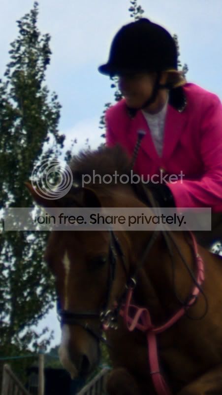

So much better to time the shots well now! However I think the lens I'm using is causing problems. Pretty sure it's nothing to do with the body as I have another lens with knackered electronics that doesn't suffer the same problem.
Lens is an EF 35-70 and all looks to be in order. Judging by the crops below though something's amiss... any ideas chaps?
I'm a bit confused, what exactly is the problem you think you have?
Particularly the sky bleeding out over the black helmet. One side I could understand (complimented by a red fringe on the other side, not blue both sides), and could correct in software, but both sides? Also if you look at the pink bridle, it's almost glowing and lighting up the dark horse around it. Looks not right to me! Particularly as a kit lens with no electronics doesn't exhibit this at all.

Shot raw, same artifacts before any PP
edit: and the jacket really is that bright... scary stuff!
well there is some purple fringing and general lack of sharpness.., then again this is a 20-year old kit lens!

I'm not too worried about the lack of focus, just the purple fringing and glowing pink parts.
It is a 100% crop, as said above, maybe it is just too old and wobbly...
It attains a similar level of focus on stationary subjects
To be honest it's not the best shot to draw lots of conclusons from, as the subject where the problems are occuring is obviously moving. My thinking that some of this could just be caused by mottion blur, and I see that the lens was at f4.5 (I don't know what the lens was but if it was wide open at 4.5 it woun't be as sharp as the lens can do). Take some static shots and see if you can replicate the problem would be my advice.

It's called chromatic aberration (or colour fringing) it's caused by the lens not focusing all the colours properly, usually worse on cheap badly corrected lens, but it can be a sign of a faulty or damaged lens as well.
Photoshop has a tool designed to help remove it, filter/distort/lens correction that and a bit of dodging/burning and it's easily fixed.
And Lightroom has a slider called chromatic abberation which does just that.. takes away magenta or blue or green from your edges. (y)
CA becomes far worse in the corners and out focus areas. Canon 24-85mm f/3.5-4.5 or 28-105mm f/3.5-4.5 are much better and cost around £100 used. The sharpness is slightly behind extremely more expensive L, they are a tad slower but still relatively fast. However on FF they are not so good (compared with 24-70 on eos 5 film), but with 400D will be fine for a start. Colour, contrast and CA can be easily fixed in Lightroom and only takes 30 seconds to do. While I am fairly happy with my 24-70mm I can hardly justify the price I paid (I mostly use it at f/8 btw)

As for CA, is it possible for it to be blue on both sides of an object?

I'm not sure the image is that bad considering. It's an old lens that was hardly stellar even in its day. Shooting a very dark subject against the light like that is quite testing, especially at a low f/number for that lens. Is the lens perfectly clean? A smeared finger print can wreak havoc with flare.
The newer IS version of the 18-55 kit lens is very good, and great value. And if you download the latest version of Canon's DPP Raw software (free upgrade here: http://web.canon.jp/imaging/dcp/firm-e/pssx1is/index.html ) you can sort out CA, vignetting and distortion from the aberrations correction suite. It picks up all the lens settings from the file data and applies custom corrections with a mouseclick :)

To me it looks like the problem is most apparant on the rider's cuff in the posted photo..
Yep, certainly does it there! In amongst the sky creeping in on everything (and the pink jacket out into the sky)

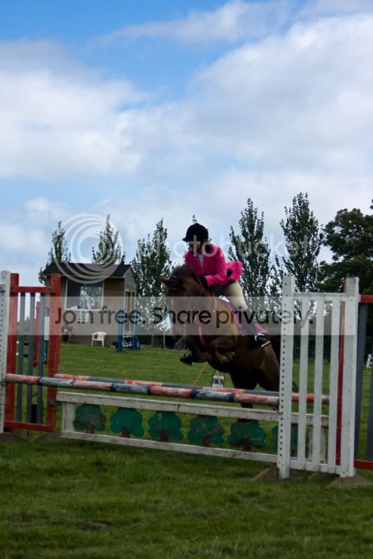

Tried it in similar conditions at f9-f11, much improved! Would be nice to have decent quality with larger apertures though...
All lenses have a sweet spot, and most this is when the lens is stopped down 2 or 3 stops, this includes expensive lenses but the difference is not so noticable.
That lens was never designed to be good wide open.

This shot would techically chalenge most short lenses, you are quite far back, using lens wide open and at long end, shooting a fast moving dark subject against a bright sky. Also the 400D is a geat little camera but it is not a specialist sports camera.
