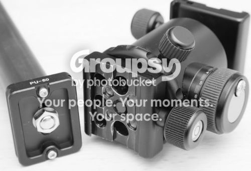

That's a permanent conversion kit to invert the head. Works well enough, but makes the head tricky to use normally when flipped over 90 degrees for verticals so really needs an L-bracket. Arca-Swiss P0 works that way as standard, superb head BTW http://www.robertwhite.co.uk/arca-swiss-tripod-heads/arca-swiss-p0-with-quickset-classic.html
A better option is a DIY conversion that allows you to turn the head upside down in two seconds. Simply fit an Arca-Swiss clamp to the base of the head, and an Arca-Swiss plate on top of the tripod. You can then invert the head any time.
