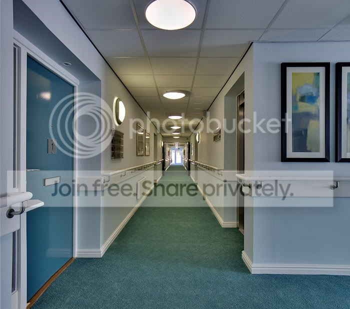

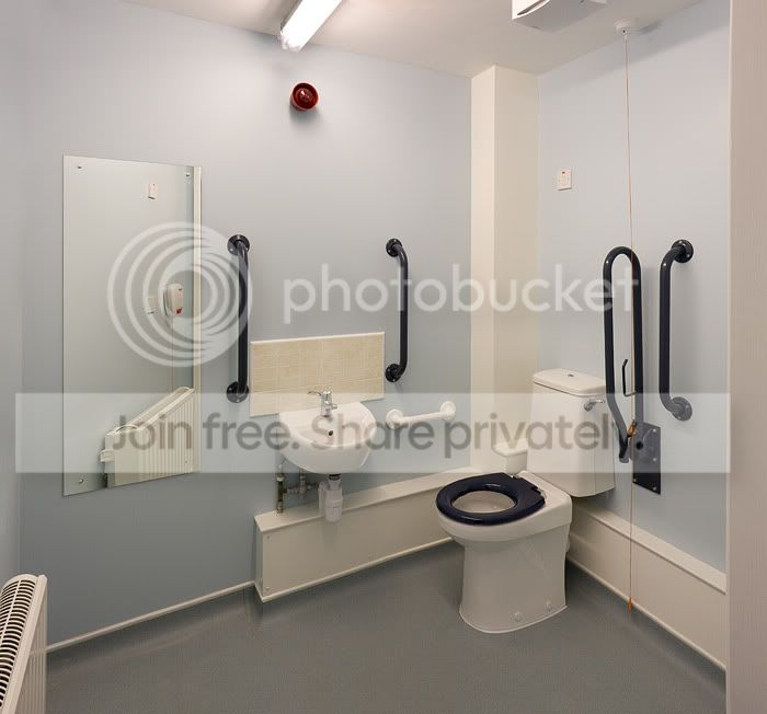

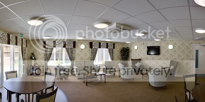

I would use what you have and get a pano bracket. Then a 28mm equivalent works very well.
It will also be useful if you start doing 360x180 real estate work... But then you will need the Nikon 10.5 fish eye or sigma equivalent.
These pics show various angles you can easily achieve with a 28mm equivalent all taken with the camera in portrait orientation
2 shots wide 95 degrees
5 shots wide 150 degrees
6 shots wide 165 degrees

Thanks Terry - i hadnt thought of this option, to be honest i dont know a lot about the fish eye and pano bracket but i will definitely be looking into this in more depth. I like the sharpness of your images together with the scale of rooms you have photographed. i did a google search on this equipment but it looked quite basic which is fine but is it easy and quick to use?

I use a nodal ninja 3 mk2 but the nodal ninja 5 is a better option.
I use my standard 17-55 f2.8 lens at 17mm for these.
I use PTAssembler for the stitching.
All the shots were by available light.
I find it very quick to do But there is the usual learning curve.
Most of those shots could not have been taken any other way,
they are either too wide or too wide and high to do them with a wide lens.
You do not need a fisheye to do the shots like mine.
