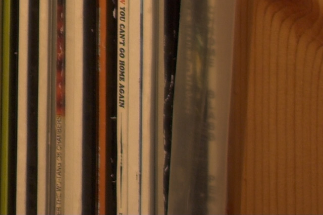

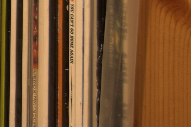

Before I start, two things. Firstly, this isn't a proper in-depth review because I don't have the experience to write such a review. This is just from a newbie's perspective. Secondly, by 'kit lens' I'm referring to the EF-S 18-55mm f/3.5-5.6.
I'm going to begin with the most important point for me - sharpness. Frankly, I couldn't see any difference. Sorry if that's photographic blasphemy but I really couldn't tell that the 16-35mm was any sharper. Certainly not nine hundred-odd quid sharper, anyhow.
Here are two straight comparison shots. Both are 100% crops and taken straight from the RAW file with no processing. I set up the 20D on a tripod with the 16-35mm attached. Framed the shot. Autofocused. Set the aperture and shutter speed manually. Took the shot in self-timer mode. Changed the lenses. Autofocused again and took the second shot. The camera wasn't moved and the settings weren't changed between shots.
18-55mm @ 24mm, f/8, 1/80s, ISO 100:
16-35mm @ 24mm, f/8, 1/80s, ISO 100:
If I'm missing something please point it out but those two look hardly any different to me apart from a bit of difference in the distortion. But the sharpness seems to be remarkably similar.

Enjoyed reading the write up Jamie. If anything, on my monitor, I think the 16-35 just has an edge on sharpness. However, I would agree that 750-900 oncers is a lot mullah for a little difference.

Oh yeah... Don't get me wrong. I can see a tiny bit of difference here too. But make no mistake, it is tiny. I enjoyed using the lens but I shan't be investing until I know enough to work out why I can't see much difference.

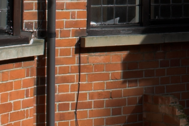

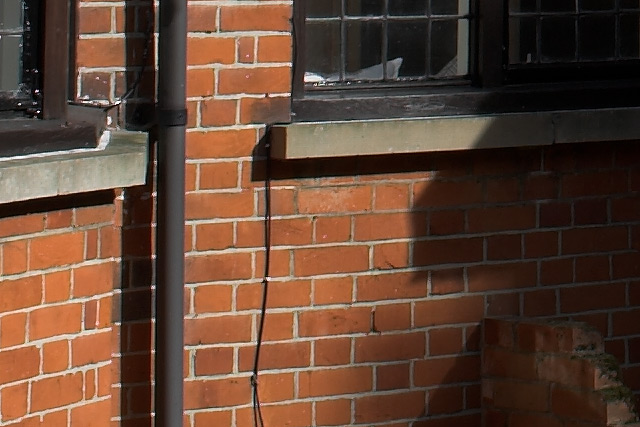

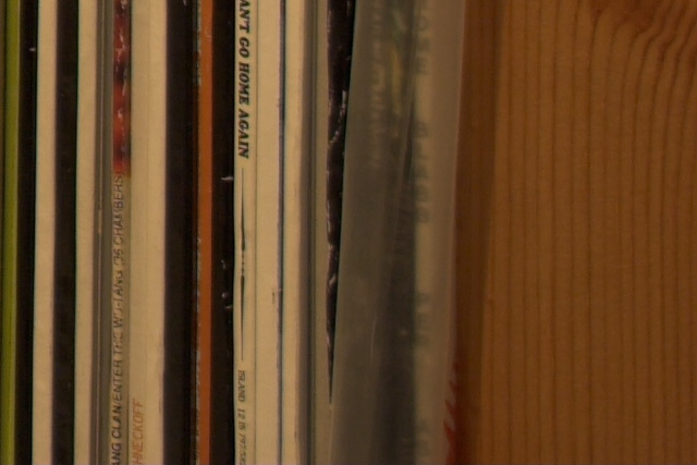

Right, these are all 100% crops taken from the bottom right corner of the frame. I know they're not totally identical frame-wise. I think it's because it's hard to get the focal length exactly the same. Also when dealing with corners of an image I guess the distortion thing comes into effect. Anyway here you go. I've included the 16-35mm at both f/3.5 and f/2.8 as I didn't know whether you wanted a like-for-like comparison or a properly wide open comparison so I did both.
18-55mm @ 24mm, f/3.5:
16-35mm @24mm, f/3.5:
16-35mm @24mm, f/2.8:
I think the f/2.8 one looks slightly brighter just because I was changing shutter speeds to compensate for the shots at different apertures and I must've gone a click too far or something.

Don't forget that if you shoot in RAW, no sharpening is applied in processing anyway. It's also generally agreed that the 20D tends to produce images out of the camera a tad on the soft side, so to properly compare the two lenses you'd need to process for optimum sharpening of images from both lenses to make a fair comparison - the resolving power of the lens is there with digital, but just needs bringing out in processing.
657
#9
Is it me or does the 16-35 f2.8 image look sharper than the 16-35 f3.5 ?
I know they are on the same focal plane but if anything it should be the otherway around.

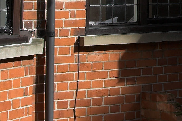

Ok, this probably isn't what you meant but I re-did the two shots of the house and this time I gave the images an unsharp mask using exactly the same settings for both pics. It begins to become more apparent that the 16-35 is sharper. It's not a small difference but it's not a huge one either. And bear in mind we're looking at a 100% crop and talking about a good £700 price difference at least.
18-55:
16-35:
CT
TPer Emeritus
28,411
#11
That's a better test by far Jamey. I see a huge difference there now mate to be honest. You'd really see the difference in making large prints from the two lenses, much more so than viewing the pics on a monitor. The other thing is that the image contrast in the dearer lens is miles better, no doubt due to superior glass and better lens coatings. Just look at the difference in the visble shadow detail on the right of the shots!
It's a lot of dosh I know, but you really do get what you pay for where lenses are concerned. You just have to decide if you can justify the price based on your anticipated use of the lens. Given your leanings towards street photography, I would have thought you'd use it a lot?
It's not a race mate - wait till you can afford it, but don't be tempted into a cheaper alternative just because it's more affordable, that way lies long term regret.

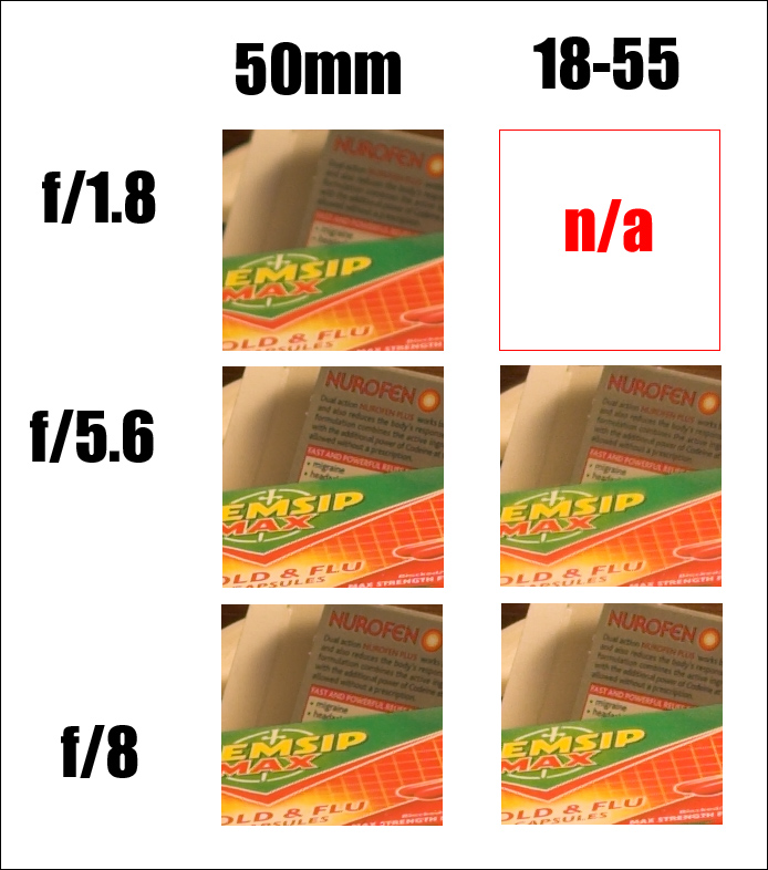

Here's a quick comparison I just did with the 50mm f/1.8 against the kit lens. They're 100% centre crops. Don't have time to do corner crops right now. For some reason the camera metered about 1.6 stops darker with the kit lens on (no, I didn't have a CPF attached, before you ask) so I boosted the exposure of the RAW files for the kit lens shots by 1.6 stops to compensate.
