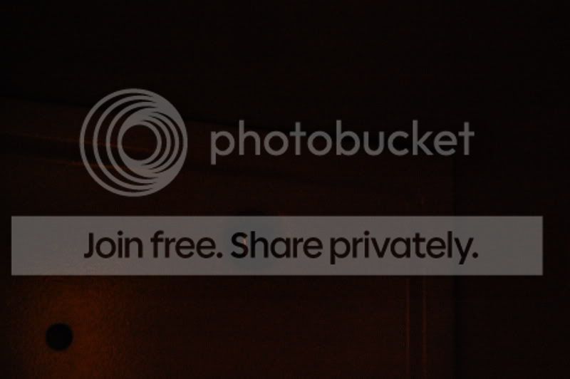

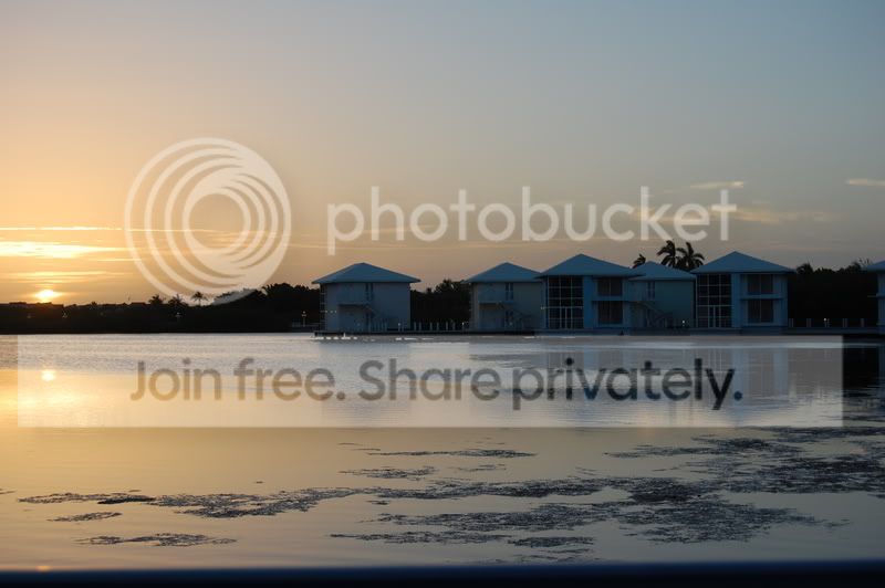

Could you post a pic here taken with the flash (which obviously won't fire) so we can have a look at the exif data?

can't remember if the flash was going off or not on pic 1, but it should have gone on pic 2 (picture of inside secuirty box during holiday, too test flash)
pic 1:
pic 2:
From the exif:Flash = Flash fired, auto mode, return light not detected
At least we know from that that the flash is "firing", now all we need to do is figure out why it's not.....
