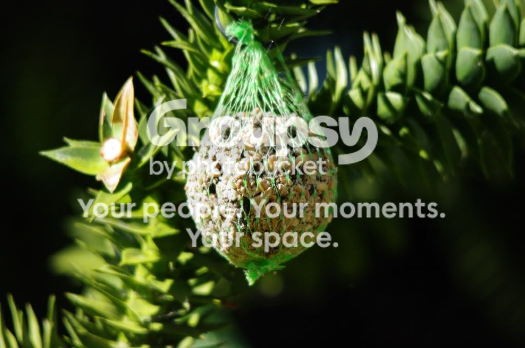

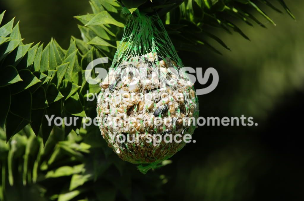

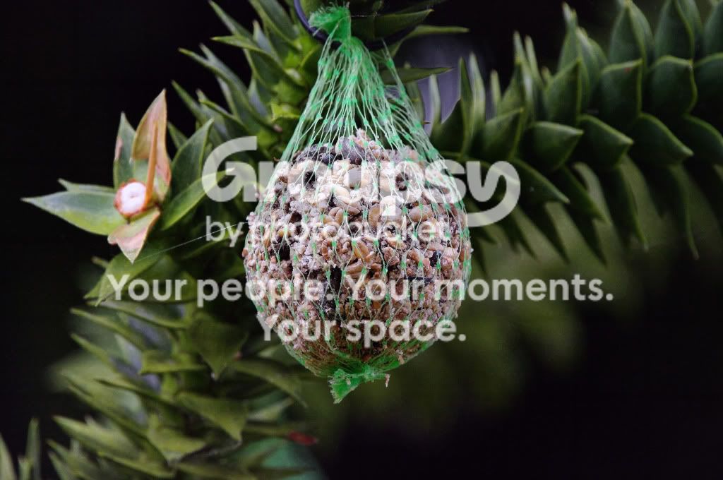

and just to show.
heres a pic from my bad 150-500mm at 500mm wide open 1000/sec
same settings 170-500mm
150-500mm not even as sharp at f10.
