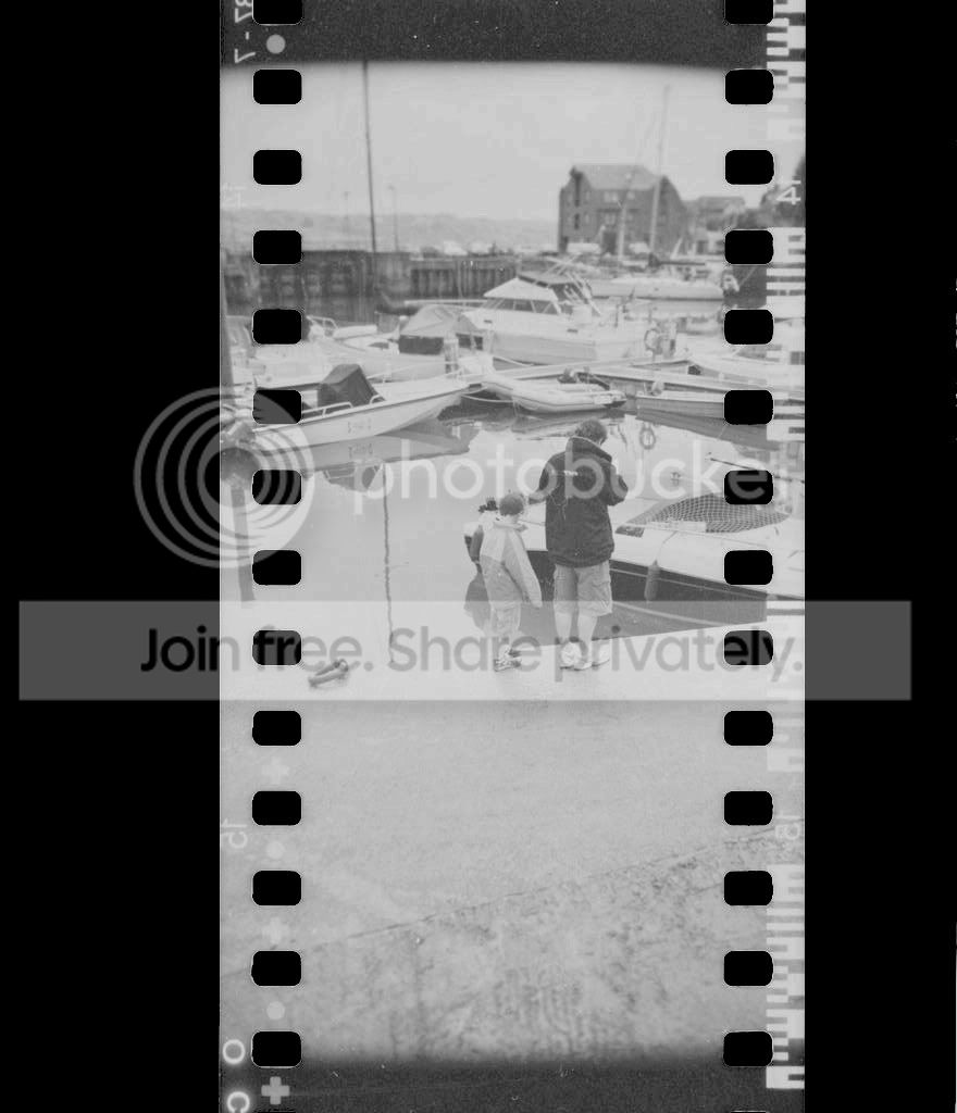

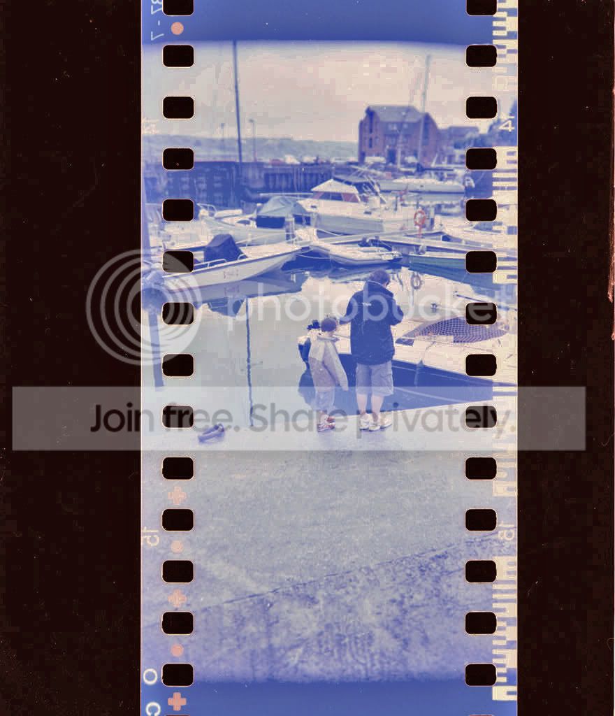

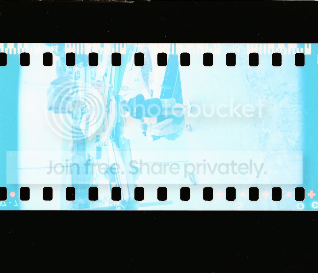

when i try to scan my negs in it comes out like this. if i play with the curves and levels it makes it better...but still way too blue,
i want to be able to see all the warm tones and colours :(

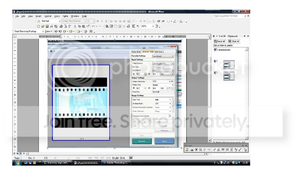

here is my tried out but failed:

Try taking a screen shot of your scan window. Just press 'Print Screen' on your keyboard which copies the screen to memory. You can then open it in any reasonable processing package and post a copy here.

I'm guessing it could be that you're scanning negative colour film but the scanner thinks it's slide film and and is applying the wrong colour correction (or visa-versa)
