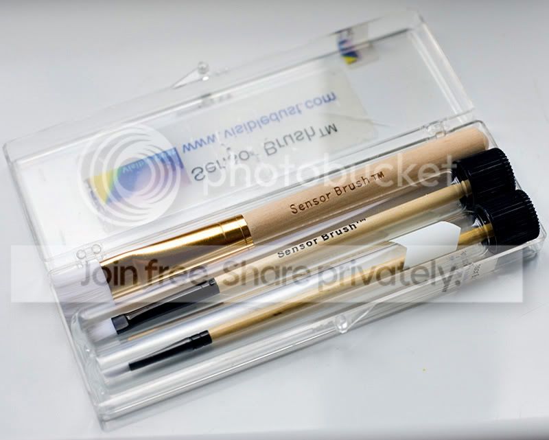

Just a small / quick review of the Visible Dust Sensor Brush.
Website http://www.visibledust.com/
I bought this set from Ebay for £17. Its the old packaging see website for new stuff.
In the set you get the following
20mm wide brush (for 1.3 crop sensors)
8mm wide brush
3mm wide brush
The 20mm brush is for cleaning the sensor, 8mm brush for cleaning the sensor box, and the 3mm brush is a spec grabber for the sensor.

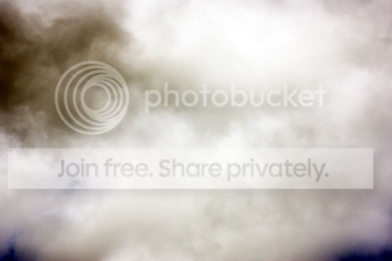

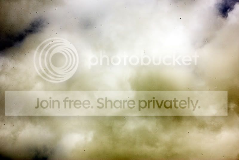

The sensor pics of before and after are shown below.
Before
After
This is the first time I have used the Sensor Brush, and I found it superb.
Much easier than cleaning with pec pads, sensor swabs, and eclipse fluid, and no chance of scratching the glass / sensor.
