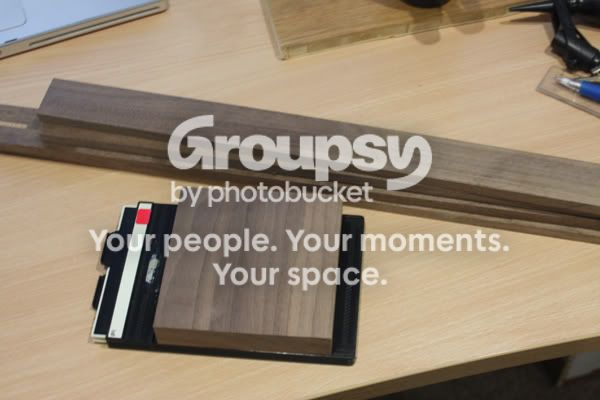

I have been planing on doing this for a while but I finally found the time to go to my local joiners and see if they had any spare hardwood...
The guy was more than happy to help and cut me up some really nice walnut! I am probably going to make two as I need to cut the front piece in half anyway. The plan is to get it around 40-50mm which is nice and wide on 5x4 with a 0.3mm pinhole which I already have (pinhole-solutions)
I will document my mistakes here :D

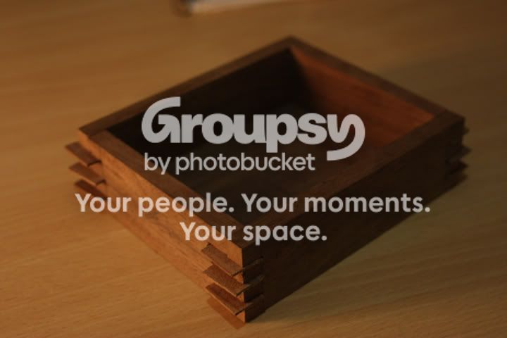

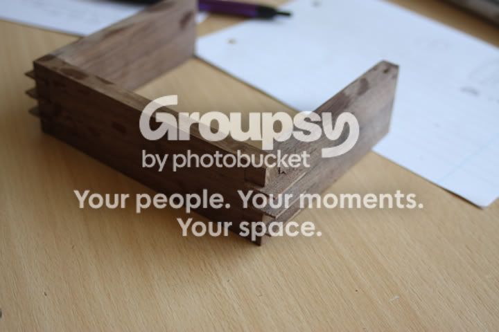

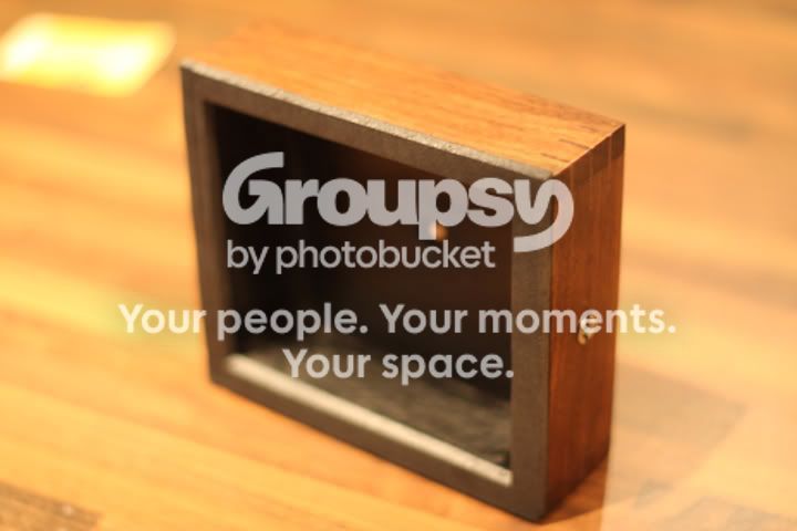

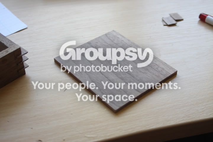

Ok, I have now designed the camera! Cut the wood today and have attached it all together using a funny joint I made up that will hopefully do the job and look good. I would love to do a nice a finger joint on all the sides but I don't have access to any tools other than what I can find in the shed.

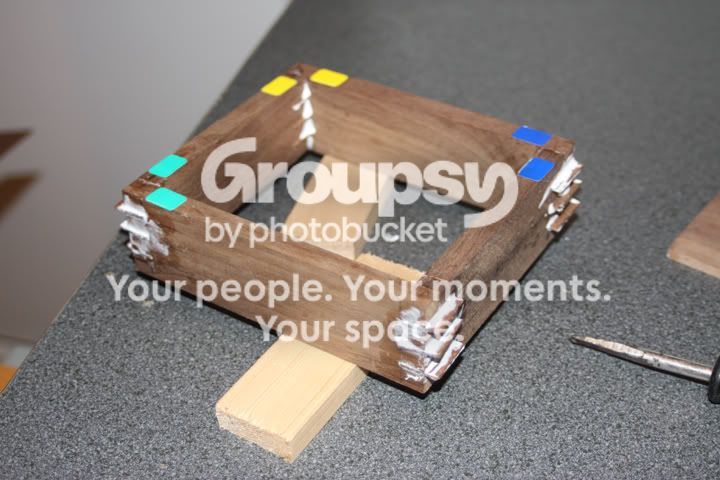

Going to sand all of the outside removing the bits that are sticking out..
that should look quite nice when it's done :)
Putting me to shame though .. I must make a start on mine !

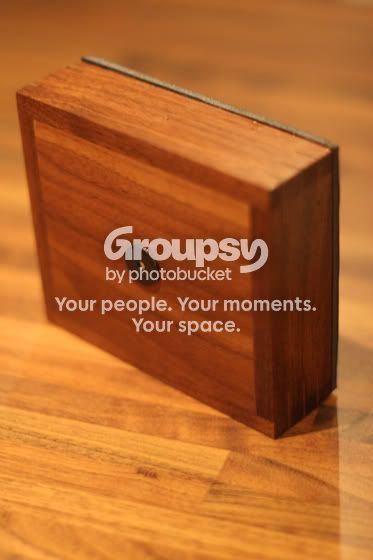

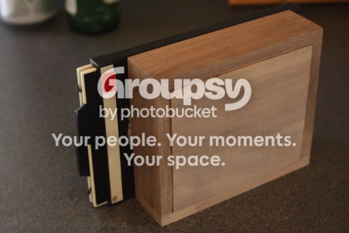

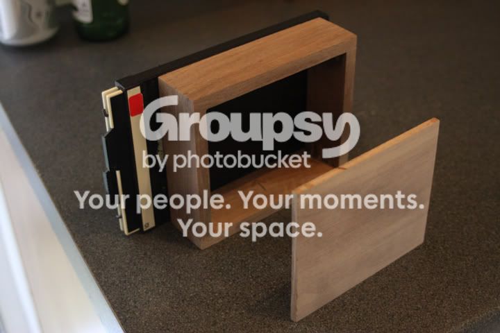

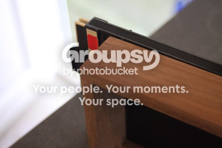

I woke up at 7 as I was so excited about sanding, so by about 8 it looked like this..
As you can see the holder is going to be strapped to the back which means the chances of light leaks are looking high at the moment. I am going to put some black foam on the back which should hopefully work.
I just need to drill some holes for the bubble level / tripod socket and pinhole but I need to revise now..

This.....is.....just.....beautiful.... :clap:
Cheers!

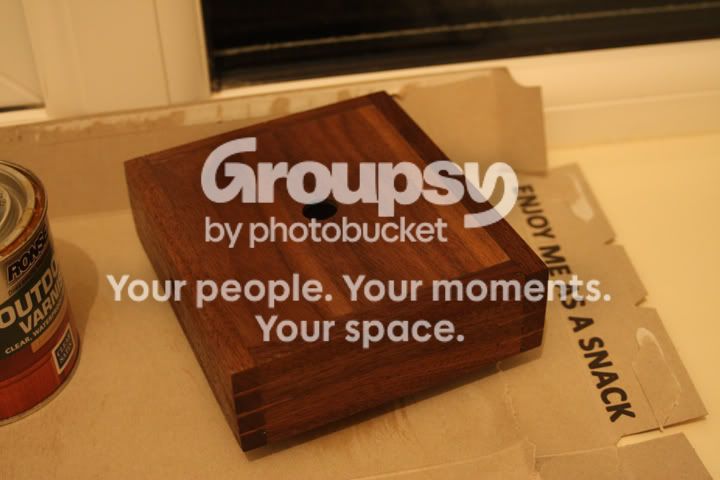

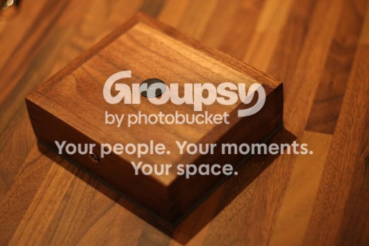

I have almost done everything now, its just a case of giving it a couple of layers of varnish and then screwing/gluing everything on...
I love the neat finish you've got. My own woodwork skills are much less zen minimalist, and much more wabi sabi..
Its finished! Here are a few quick snaps, its going to be a while before I can actually use it as Cardiff uni need to sort out a darkroom..
Looks really good Liam !
Cheers guys, can't wait to use it but it will be a miracle if I don't get any light leaks! I think I might have to redesign the rear to stop light. The next design will probably use a back from a 4x5 camera...
