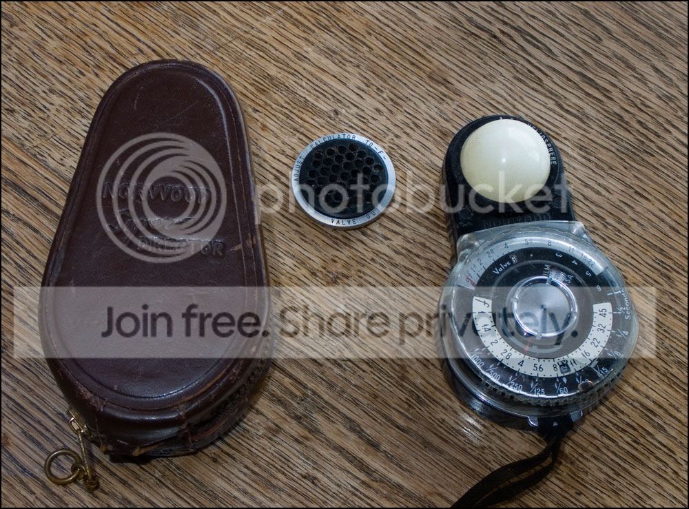

The earliest Norwood meters were made to his patent by various manufacturers, they included the first Norwood Director type A in 1947 through to the Super Director a new Patent and made directly for him by Waltz. from 1958-1960. The various models made from1956 till today by Sekonic were based on his original patent. To these can now be added all the Digital flash/ambient meters made by Sekonic, Minolta, Gossen and Spectra. The original patent ran out in 1960
(I still own this Norwood Super Director bought new in 1958 and made by Waltz).
