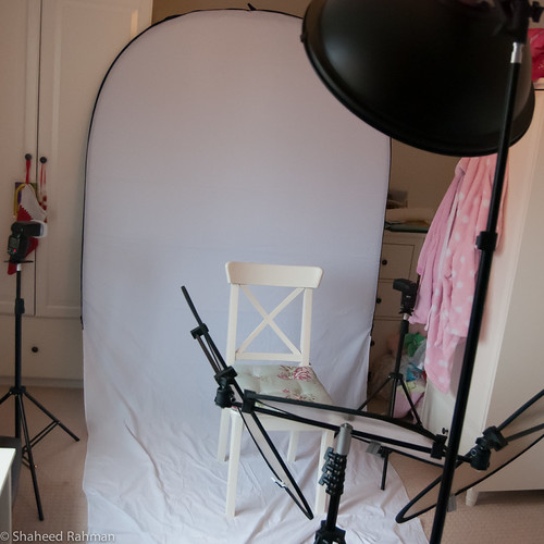

The photosel background is pretty handy and not too pricey!
This is the first one I could find on my Flickr
Set up-011 by Sir SR, on Flickr
Using this set up
