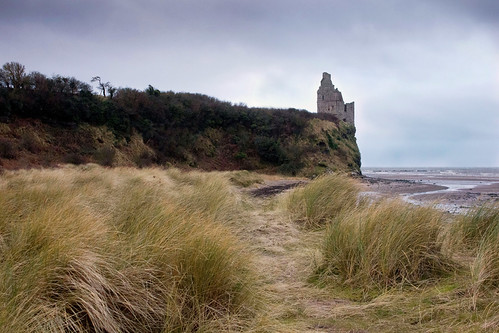

Another Day another go!! at Doonfoot beach and Greenan castle.
Well I am going to have to resort to getting some filters as once again I lost all the sky.
This landscape photography is not easy!! lol! but one thing is I am learning every day so that has to be my reward for now.Good shots will come!
Greenan castle by cooriedoon, on Flickr
Your problem with Dynamic range is much more important than your focus issue (focussing issues are just technique).
You'll never capture this the way you want in the manner you're trying. At the brightest part of the day, the sky will blow when the foreground is correctly exposed, or you can expose for the sky and have the foreground underexposed.
The options are; combine exposures in post processing - don't think of this as cheating, it was done in the darkroom by all the oldschool landscape photographers.
Shoot it at better times of day, when the difference between the sky and land are less, notably the hour before sunset and the hour after sunrise. You'll find that the light colour is more interesting at these times too.
Before you go out to do the above; Find 5 great landscape photo's on FlickR. Think about the quality of the light in them. Do you think the photographer rocked up somewhere interesting at mid-day to take those photo's? You've just realised lesson no.1 It's all about the light.
caveat - I am not a landscape photographer, but I do own a rucksack and some waterproof trousers.
Phil yes you are right about the best times to shoot. These were taken roughly about an hour before sunset. I was just leaving as the sun started to go down as I was babysitting.
Just wanted to try and get in anther practice using sea sky and land and to grips with exposure etc
I will be back out at sunrise one day later in the week to do the Turnberry ones again so that might be better. Still think it may help if I get a ND filter too any suggestions on which one to begin with?
My reason for wanting to master this is because I am going with some friends geocaching around about Loch Ard and there are some amazing shots to be had if I can improve before I go.
Not an ND filter - that will affect the exposure of the WHOLE scene ( so you will still have the dynamic range issue). You need a Graduated filter and you move the filter into the correct position according to where the sky is in the frame.
The ND Grad can be at varying degrees of darkness and using the right one(s) will depend on the difference in exposure between the sky and the ground.
Shooting three to five frames at different shutter speeds from a stop or two under exposed to a stop or two over exposed will allow you to merge in Photoshop and give you the dynamic range you need.
The issue here is that you are not understanding how the camera is exposing the scene. As Phil says that is a bigger issue than focusing

Ok been back out this morning,to be honest way to early should have checked when sunrise was and had a longer lie in. :)
Now I have some shots that have the sky I want and castle way too dark and some with the castle just right and a blown sky.
No idea how they will look when I get them into Lightroom but I will have a play later today in photoshop and see what I can get.
As stated already, the light makes all the difference* as I found out when I first got my camera. This was taken a few days apart.
*and changing composition.
I'm a bit late to this thread, but I never use any Grad filters or Polarisers
I don't understand why anyone would want to unless they are shooting a perfectly horizontal seascape. If there is anything jutting up, as per your castle thing, then you are trying to correctly expose your sky and foreground, but then underexposing the main subject of the castle and having to dodge it back (potentially making it noisy); just seems daft to me
As Phil said, shooting at a time when the dynamic range is within what your camera can record is the easiest way; second is exposure blending when you use a layer mask to rub out the over/underexposed bits (layer masks are better than the eraser tool as if you get a bit wrong you can put it back in)
The grad tool in LR is FAB and so what if you get a slightly noisy sky, you may be surprised at how little noise shows up in a print compared to onscreen. A common beauty/portrait trick is to add noise to smoothen out backgrounds and even skies !!!
I usually go with my blinkies for the sky's exposure and let the land take care of itself to an extent, bringing out detail in the sandy/rocks on a shoreline may create a smidge more noise but isn't sand 'noise' anyway :D
I'd certainly suggest you spent more time on your PP and LR than on filters until such time as you are positive shooting better and PP isn't the answer, but for me, filters are a waste of time, effort and money
Happy shooting :)
