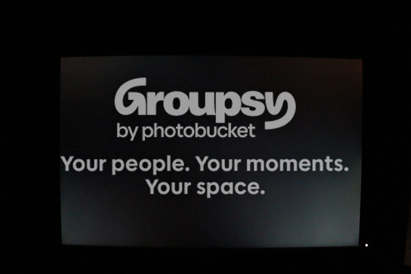

Thanks for all your help! I took the plunge and went for the Dell U2413.
My first IPS panel so I was expecting a little IPS glow, even less with it being a higher end model but wasn't expecting it to be this noticeable.
Is this an acceptable amount?
