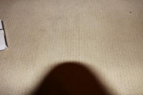

It does it on the D300 as well, as you can see above with the 24-70mm, I think the hood was on to keep out the rain. I only tried it on this shot out of desperation for a bit more light.

Don't ask about the picture it's a long story!
