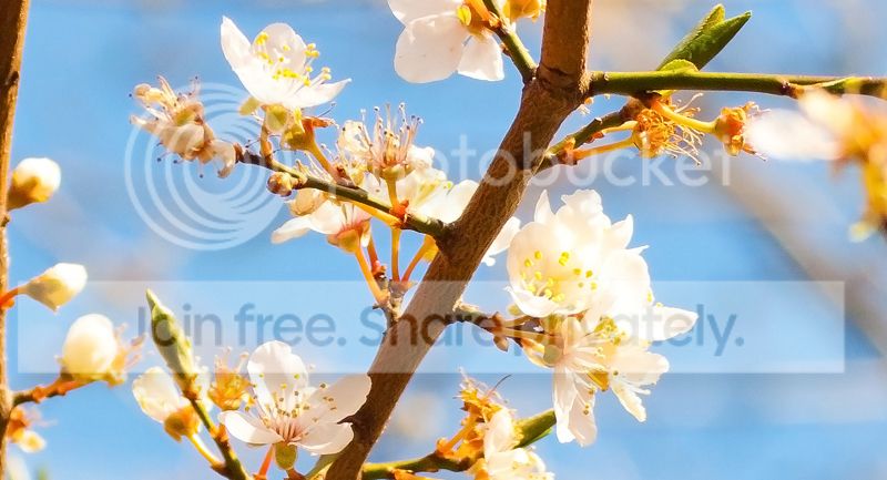

I took my brand new second hand 50mm f2.8 macro out today. This is someting like a 100% crop... Tiny flowers, it's via Photobucket so will be mangled a little but the original is sharp enough.
It seems to be a really good lens but handholding at an EFL of 100mm is rather difficult and when attempting to get anything near a full frame great care is needed, and a fast shutter speed :D

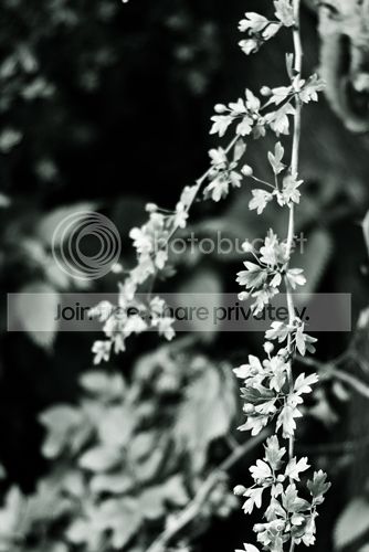

I revisited a Rokkor 55mm f1.7 shot I took some time ago and did a mono / split tone...
