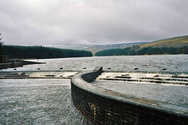

A stream runs under the middle of this house:-

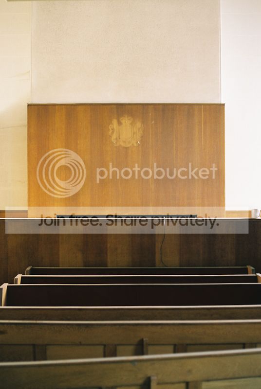

First go with the Prescysol EF on one of two films I exposed for the purpose of testing their claims of being able to develop different speed films at the same time, this was from a roll of Tri-X and when I first opened the tank I was pretty underwhelmed to be honest, the negs were very thin on both films (the other was a roll of FP4+) with the frame numbers being quite faint. I had followed the instructions completely to the letter giving a pre-soak of 5 minutes along with a dev time of 10.5 minutes for partial stand development at 24 degrees C with continuos agitation of the first minute and then 10 seconds agaitation every 3 minutes thereafter.
My next films will be developed for 13 minutes with everything else staying the same.
In saying I was unhappy with the negatives I have to confess that they did actually scan quite well, and although the grain was more noticeable than I would have liked it was quite balanced across the film with no large clumps. The overall pictorial quality was not unpleasant.
