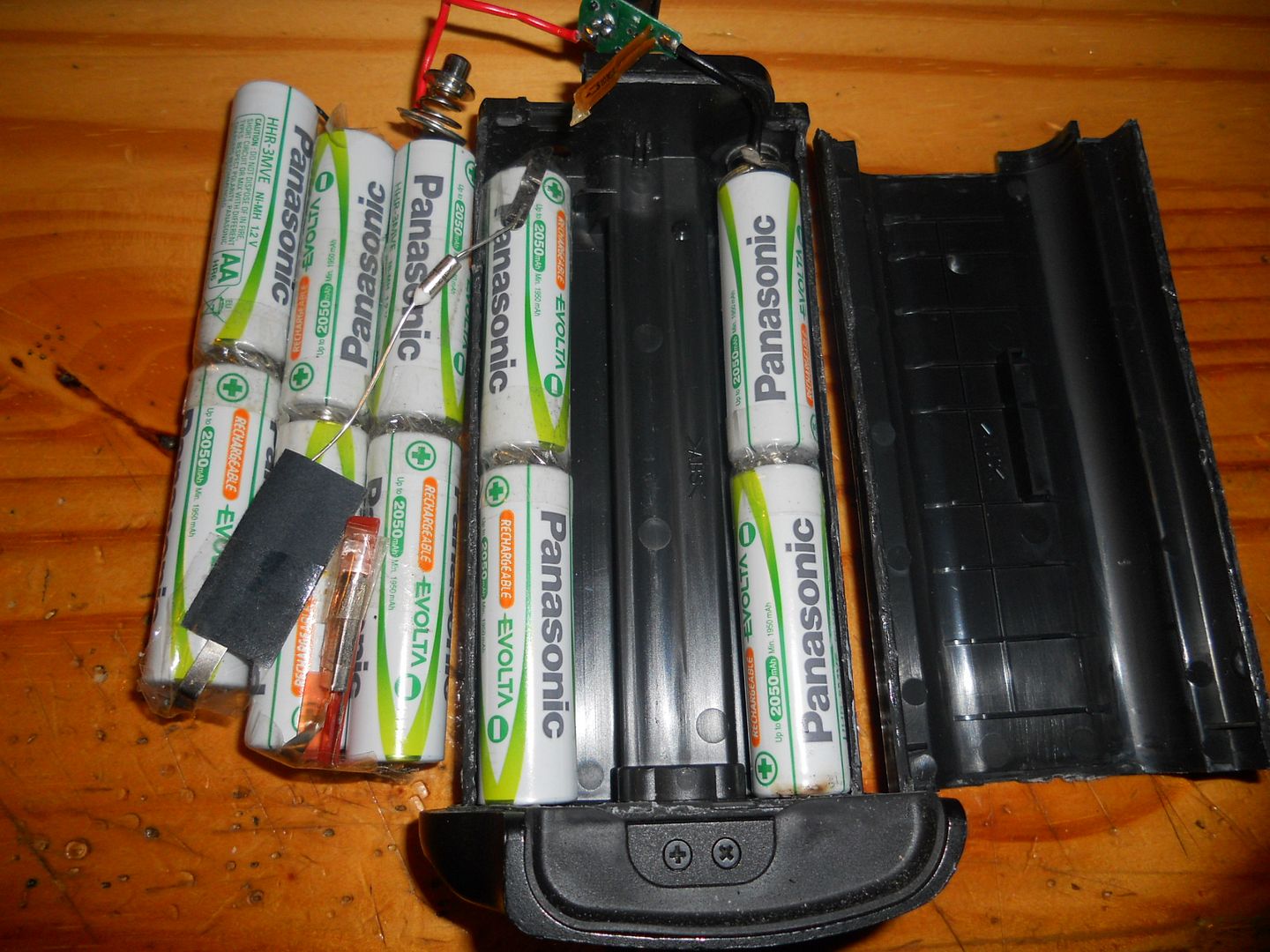

I smelled smoke when I was charging my oldest Canon NP-E3 battery this morning - just as well I was sitting next to it. This battery must be all of 10 years old, and was still good for 100 captures or so.
I decided that as it was jiggered, I'd open the case. Look what I found. The list for a new one is close to £300. This is a rip off!!

This is pretty standard construction for a battery pack. Sometimes it's complete batteries like this, other times it's just the component cells.
Got to be worth trying replacing the cells. As long as you didn't completely b****r up the case getting it open.

assuming the electronic bits are o.k replacing the batteries with modern ones should not be a problem ,but what bothers me is why the one on bottom right is showing signs of burning and could point to something other than the batteries ,if you can find a good sparky that can check out the other components to it might be worthwhile

It was indeed smouldering when I unplugged the charger. and when i opened the case, it was still too hot to touch. I've tried charging two other batteries, with two different chargers and two cameras. All appear to be working correctly. I think I've already decided to go with the 7 day shop alternative. Everything I've had from them in the past has been perfect.
the ones i would go for personally are vapex 2900mah ones ,they are deemed to be the best available for charge holding and power output .but its your choice and as musicman said beware of actual size of the cells as canon may well have had these specially made to fit the holder and thereby justifying the price ,i know from past experience with nicads and nimhs that they DO vary in size quiet a bit .it might be worthwhile extracting one entirely and taking it to a shop (marlins etc) and making 100% sure the replacements are the right size .
if the batteries are going to be soldered in series as well clean both ends with fine emery cloth and apply meths to de-grease before attempting to solder also try to get lead based solder as the new lead free stuff is shiite.

As for £300 for a battery - I'm utterly gob smacked. I used to work in I.T. and that would be expensive for laptop battery. The most expensive thing in some of these batteries is probably the chip that prevents you using aftermarket batteries. I don't know if this applies to these specific batteries, but it's an often used trick.
I busted open my original Macbook battery and it was something similar, more recent ones have sachet like cells inside, I guess for the money nobody expects to see standard rechargable AA cells, I would be tempted to replace them myself but hey that's me...

I have built about five of these batteries for my 1d mk2n ,1ds mk2 and my eos 3 battery grip. Dead easy to replace the battery cells I use gp recyko it helps if you remove the battery covers with all the details of the battery on . They peal of dead easy.
A lot of batteries are like this internally. I should know because I used to solder them together as a part time job on a conveyor belt for several major manufacturers. It's not just AA batteries but a whole host of them. The amount of clothes I went through when one exploded due to a misplaced solder. You should be able to repair this yourself with a soldering iron.
