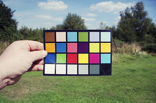

When I scan slide film, I occasionally have problems that the darker sections of the slide are just not really touched by the scanner, probably the same principle as you get nasty noise on digital shots in the dark bits if you shoot RAW and use recovery to get detail in dark bits. Conversely, with Colour Negative, I seem to get fewer problems with dynamic range, if anything the noisier bits are the light areas - which are dark when scanned, then inverted in software of course. Shooting C41 would be fine, but then you have the problem of colour correction for the orange base of the film - each film being a little different. I've been known to shoot a frame with a colour checker card in frame before taking shots, purely to ease colour correction in lightroom/CS5 at a later date.
