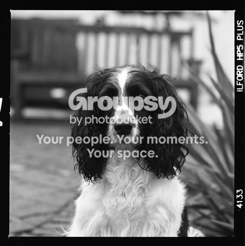

The framer didn't actually know what acid etched glass was but sold me a piece of his non reflective glass and it seems to work. Just posted this in the show-us-yours thread but to save you hunting here it is;
That was on a V700, film area guide and glass, non reflective side down.
This is the same, scanned without the glass sitting on top;
Tricky to pick up and it really attracts fingerprints so I intend to attach a strip of tape leaving an overlap to hold it with.
Glass was £2.40
