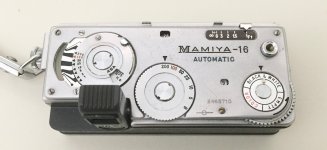

The camera, a Mamiya 16 Automatic.
It's an Automatic, Jim, but not as we know it! Automatic here simply means that the lightmeter dial that you turn to match the selected shutter speed with the light meter needle is mechanically linked to the aperture blades, so that as you match the shutter speed to the light meter needle, the aperture is 'automatically' adjusted.
Per Wikipedia, it was launched in August 1959.
Lens is a 25mm Mamiya-Sekor f2.8, stopping down to f16. Closest focus is 1 foot. Per the instruction manual, wide open at closest focus the depth of field is +/- 1/4 inch.
Image size on film is 10mm x 14mm. There is a PC socket on camera base plate with accessory shoe on the side for flash. Size is 104×32×48mm and weight 270g.
