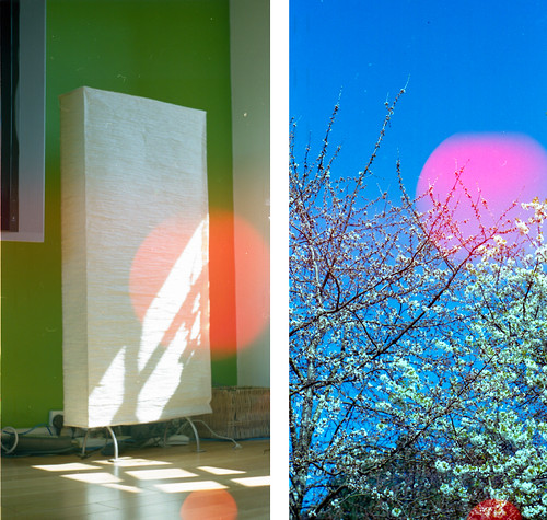

I decided to set up my zeiss ikon nettar to take a roll of 35mm film. I got the inspiration from a member here (i think it was Ambermile), but noticed when I got the film developed that there are orbs of light in most frames.
Is this a leak in the nettar's bellows??
Also, Ambermile, how did you work out frame spacing for your roll? I had so much overlapping.
It's not light leaking from the rear window (where the frame no's pop up on 120 film) is it?
I think Arthur (Ambermile) worked out his spacing by loading a old spoiled film into the camera, marking the film with the exposed frame length, then working out how many 1/4 turns it took to advance the film, with the back open.
Yes I think you are right. It was closed with the metal slider, but there must be a couple of tiny gaps. I will tape it over if I try again.
Good idea with the spare roll. I'll give this a shot, thanks!
