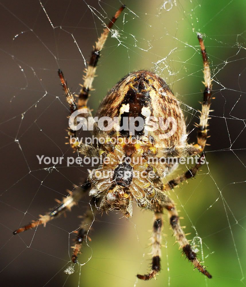

I have used a 20mm Kenko extension tube with my 50mm, it works just fine. the draw back is the front of the lens is close to the subject. However as I say it worked for me. I have also used magnifying macro 'filter screw' type lenses on my 18-70mm at 70mm, that worked for me too, however they are both cheap stop gap options, but the IQ is better than you would think . . .
This is a sample, D80/50mm/20mm Kenko tube, and then a bit of zoom in PS:
I'm not heavily into macro, so the budget option suits me.

Also be aware that at very close focus distance like CJS shot above depth of field is absolutely tiny - I am guessing CJS shot was done at or close to f/22 - certainly no less than f/11. Macro at f/1.4 just won't work..

Front of lens to subject distance can be a problem with easily spooked insects etc., so you have to be selective. Similar problem exists with short FL macro lenses, 90mm plus on a true macro lens starts to get further away? 'Depth of field' always seems to be a problem with macro . . .
Spider settings were:
ISO: 400
Aperture: f8
Shutter: 320
Metering: Center Weighted
Manual focus
As I say, I'm no expert, just dabble a bit.
CJS
gobsmacked that it was f/8! great photo though.
