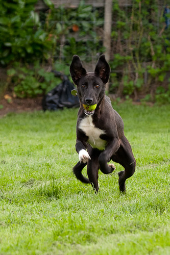

I did a lot more work with the 20D which I believe has similar AF performance to the 5D II. Excuse the processing, it's an older shot. But this is tippy going full pelt...
