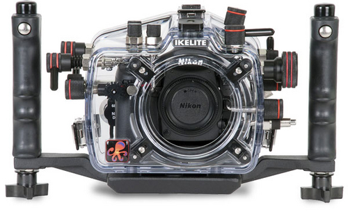

Matt, the plastic bag set up might not be as daft as it sounds, the Aquapac is an option I suppose but it looks silly. It's a shame the 5D2 isn't fully weather protected. I suppose I could always get one of these...
