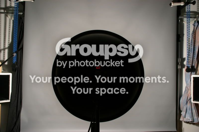

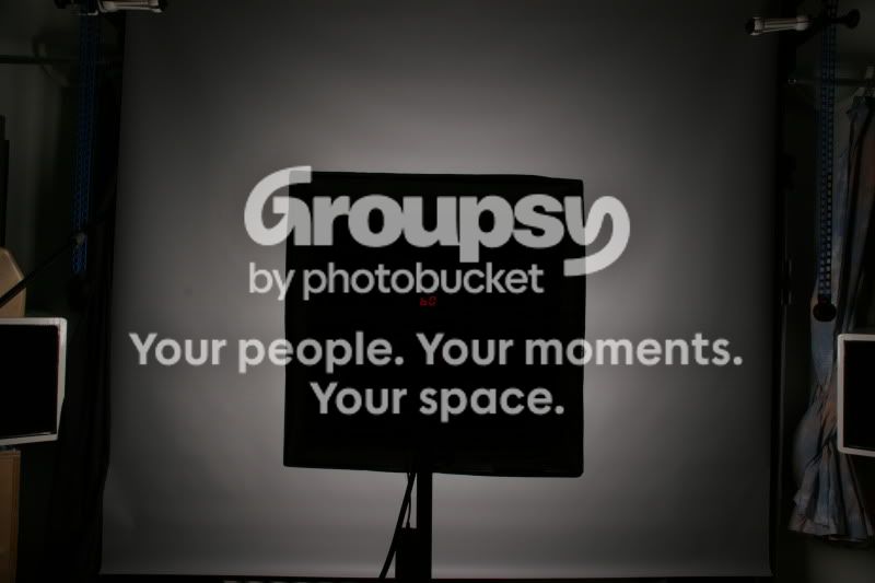

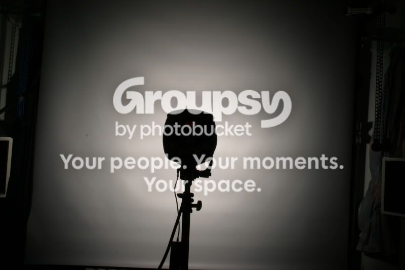

All shots taken with flash tube 1 meter from background.
Standard reflector at f22 - had to turn the head down 1 stop as I couldn't stop the lens down any further.
60 cm softbox at f16
70cm beauty dish at f11

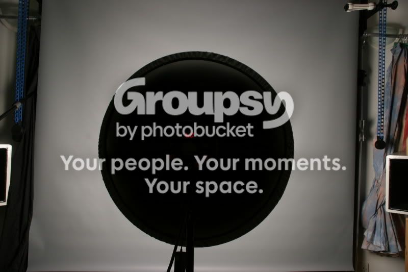

Dish with sock at f11

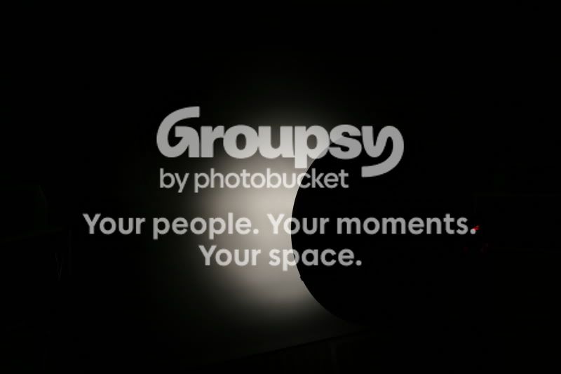

Dish with grid at f6.7 showing virtually no spill
As above but taken from slightly to the left
The grid seems to work very well and the 'plain' dish gives a nice even illumination at these close distances - far better than the little 60cm softbox.

The cutoff is nowhere near as well defined as it should be, but yes, much sharper than with a softbox.
In terms of power, a 70cm beauty dish should 'lose' around 2 stops compared to a standard reflector.

The actual cut-of is beyond the framed picture, this is no parabolic dish so 85-100 degree spread for a white surface like this one perhaps (& 60-75 for a silver?) and more or less spot on two stop difference. I should have mentioned all the pictures are over exposed by a stop as well, actual meter reading for the standard reflector is f45 at 1 meter
