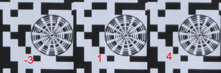

It'll depend on your camera. On my Sony A77 +1 of focus adjustment at 50 feet on a 500mm lens seems to move focus roughly 1mm. On your camera just move it from max -ve to max +ve, measure the difference, and divide by the number of focus adjust units. It may well be that the inherent inconsistency of your AF is more than 1 unit of adjustment.
No idea on the maths but one of my lenses needed an adjustment of +4 and it's made a massive difference in near and far focus :)

That'll be me then Bob. I do it with a lens cal and some tins then check it at various distances up to the very max I'm likely to photograph at. Quick to do and best of all I don't need to understand the science. :)
