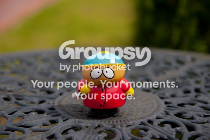

If it helps at all...
This is a test shot with a Tamron 17-50mm f2.8 (non VC) on a Canon 20D. Whole image followed by 100% crop.
I think that looks pretty good for a wide open shot.
