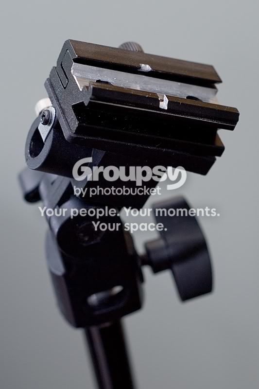

Although the OP is obviously Canon, I thought it might be worth posting this as it highlights problems I found with this popular Ebay bought 'this bracket fits all flashes' design. With my SB600 mounted the sprung contact pins actually touched the aluminium bracket :eek: which although painted didn't sound like a good idea! So I milled away about 1.5mm of the aluminium to ensure good clearance and no risk of a short circuit. The next problem is one only related to Nikon's locking system that does not use a wind-down locking nut/wheel... I found that with the flash slid into place (it can only push onto the fitting until the vertical section of the foot is up against the bracket) it felt rather unsafe and could easily fall back out of the mount. I filed two slots, as seen below, enabling the flash to be clamped right in the centre of the mount where the clamping screw of the mount is and the slots effectively trap the flash from sliding forwards or backwards out of the mount. So, a fair bit of faffing about, but at least I'm now 100% happier using it and happy to move the light stand around with the flash securely mounted on top. Makes me wish I'd looked harder for a better designed bracket at the start, but you live and learn ;)
