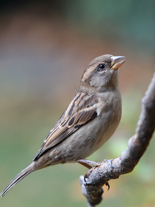

I finally got to do some testing with the 100-400L on the 7D after satisfying myself that the lens calibration is OK and doesn't need any micro adjustment.
This first shot is full frame at 400mm and f8, 1600 ISO, at a range of about 8 feet, tripod mounted with gimbal head. It's just been resized to 800 pixels with normal sharpening for the reducion in size.
A full frame 1:1 crop from the above image.
Pretty impressive I'd have to say - just lacking the absolute sharpness you'd expect when you'd really nailed the focus with a fast prime lens, but a very usable image.

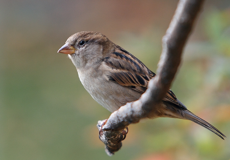

Another full frame shot at a more realistic range of about 25 feet. Again it's at 1600 ISO and has just had normal sharpening for the downsizing.
Again - a sharp very usable image I think.
Very acceptable I think given the increased range.
What I have noticed is that the lens definitely benefits from stopping down now, which I never found to be the case before, but in all fairness, the last time I really used the lens in anger was with the 40D, and the 7D represents a near doubling of the pixels which is bound to show up any minor focusing errors, and obviously a prime lens will exploit those extra pxels far better than a zoom.
So good news I think? Don't let currently using a 100-400L for your shots put you off getting a 7D, with the proviso that you'll need to stop down a little for optimum results. It's a great lens now being challenged a little by these huge pixel counts, but still up to doing the job.
