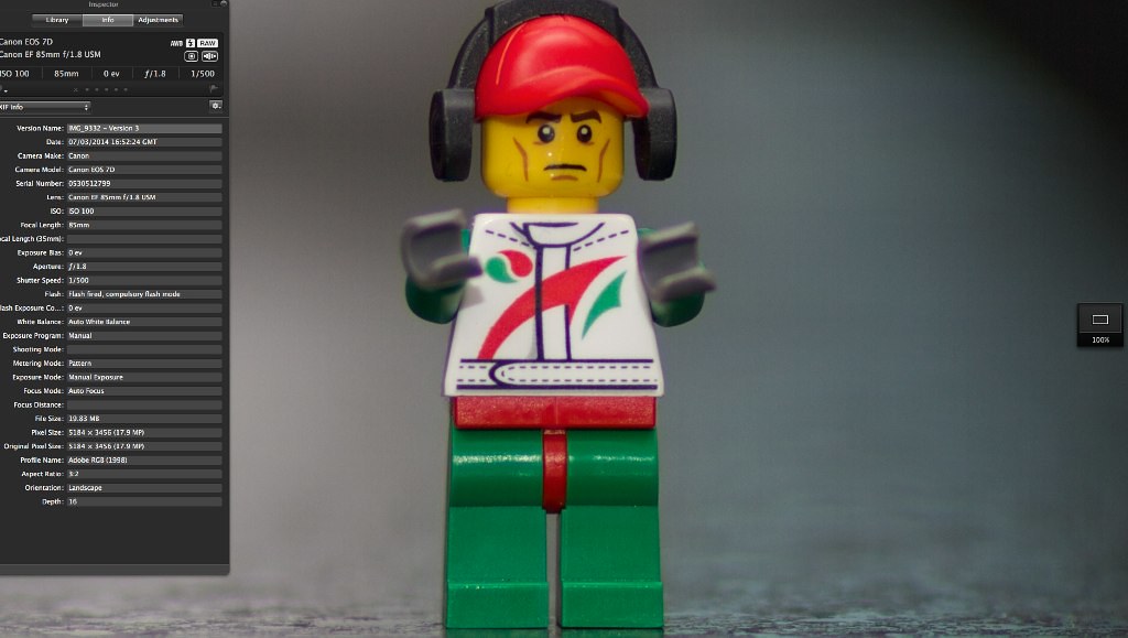

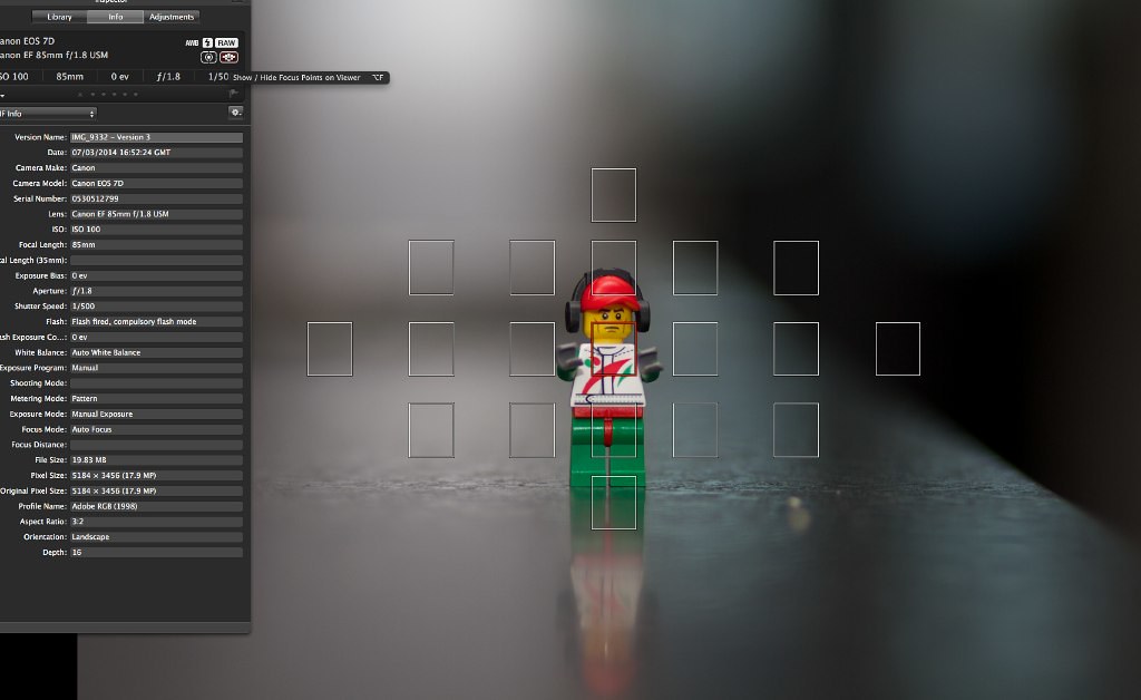

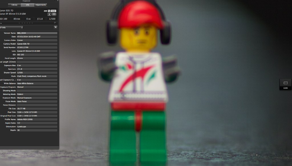

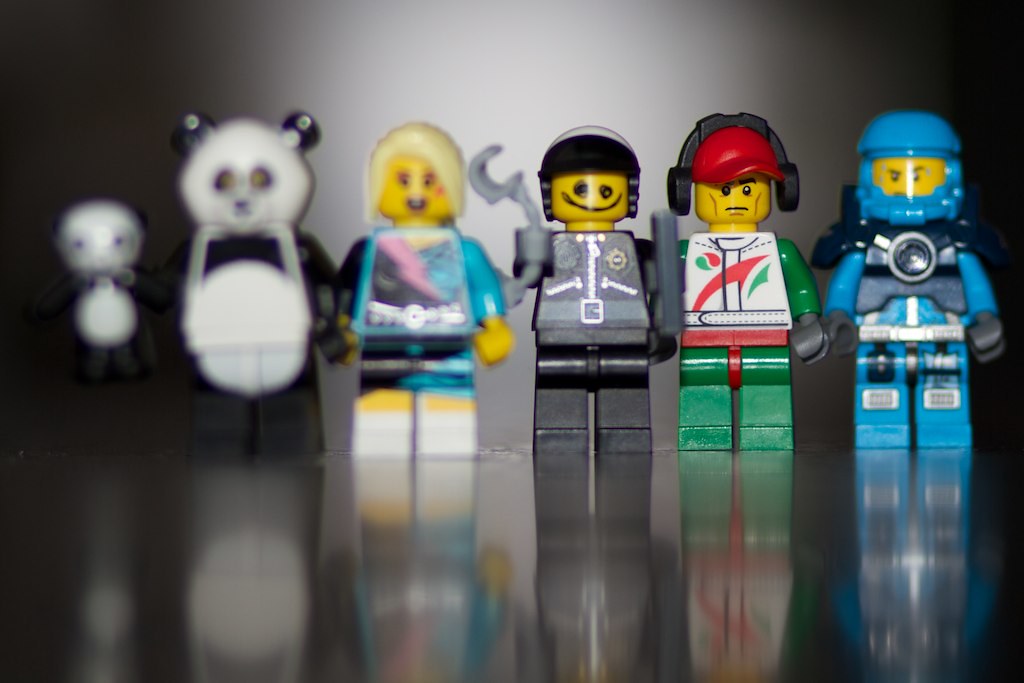

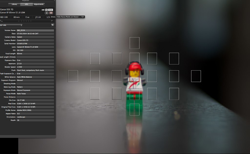

Hi all,
Just bought a new lens as above to try and get some great shots of the kids and for some low light stuff.
Lens arrived yesterday and straight away the autofocus seems very hit and miss. I know that depth of field at f1.8 is very shallow but it seems to be getting 1 sharp photo for very 20 or so!! Had a play with micro adjusting the lens following the Dot Tune method but still no joy.
Wether outside in the sun or inside with flash i can't get it to be consistent at all. I used to have a 50mm f1.8 and never had any issues with that in the past.
I have some photos to show what i mean. All taken indoors with flash and all exact the same settings.
1.
Test 1 by nessiemac1, on Flickr
2. 100% crop of above
Test 1 A by nessiemac1, on Flickr
3. Exact same as above i second later...
Test 2 by nessiemac1, on Flickr
4. And 100% crop of above.
Test 2 A by nessiemac1, on Flickr
So is it me and what am i doing wrong or is it an issue with the lens?
Dave.

You don't say what the distance to subject is but it looks short. The DOF will be razor thin and any small movement back and forth will cause problems for you.
