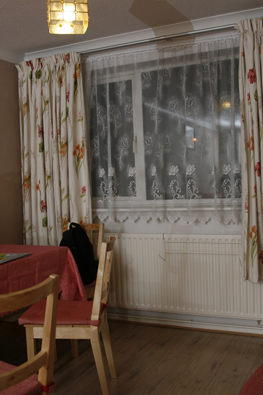

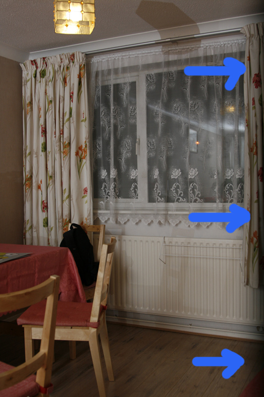

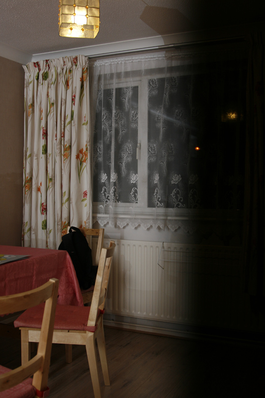

Sample pics:
1/250sec 40D with Catus V2s
1/200sec
1/160sec
