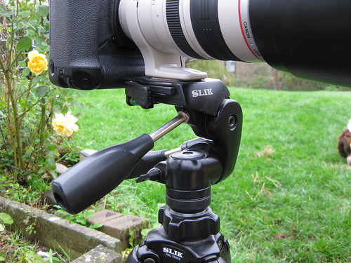

SLIK PRO 700 DX legs here and have used all manner of heads.
Not sure about the 330DX but the 700DX has a reversible screw on the top so you can fit heads that take either size thread.
Some shown here if that helps
