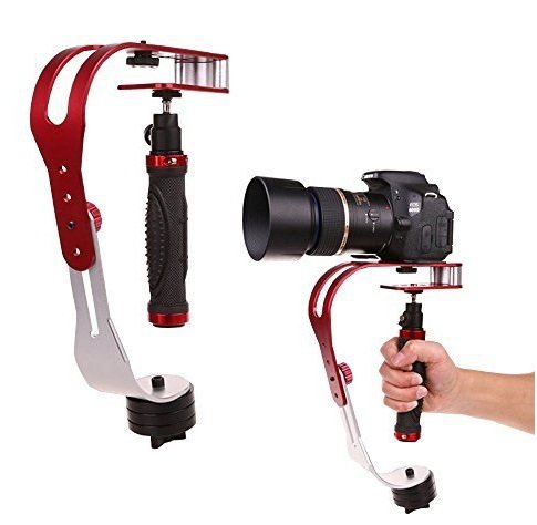

Are these type of things any good? Even if it's just to "get started"?
http://www.amazon.co.uk/Senhai-Stea...id=1456332284&sr=8-5&keywords=steadycam+gopro
I just don't see how these work to keep the camera steady compared to an electronic gimbal.... Is it simply just down to weights on the bottom helping to keep things steady?
