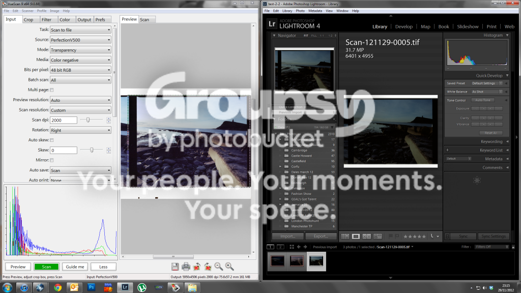

I've tried Portra, Ektar and Fuji Pro 160NS and I've yet to get a result i'm happy with when it comes to scanning. No matter how hard i try i just can't get the colours to come out right, they tend to come out with a blue tinge.

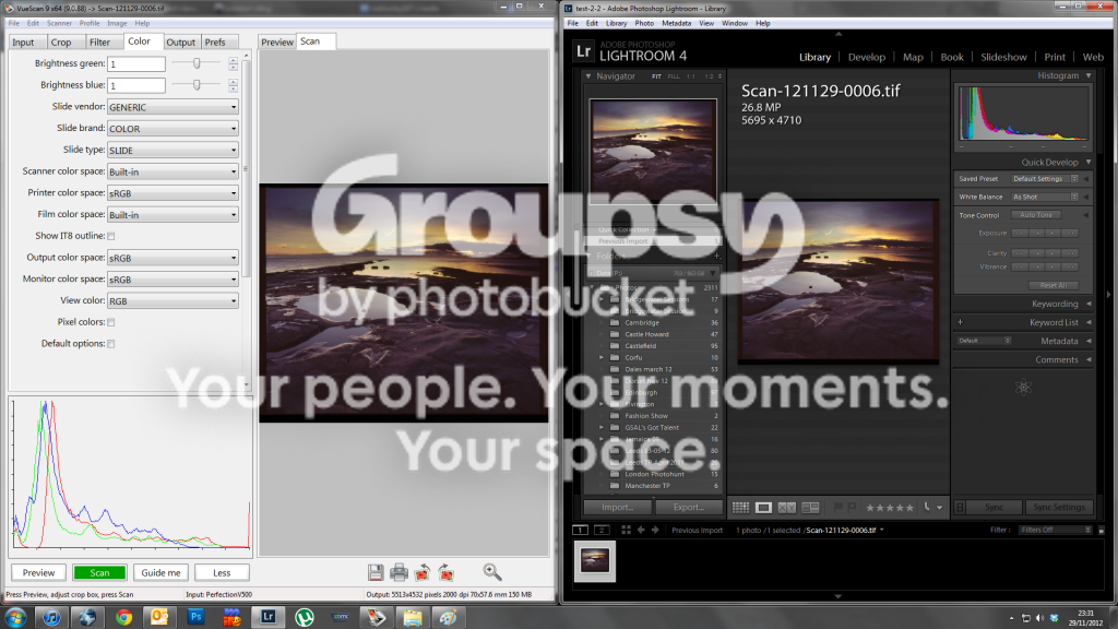

One of the issues i have is when i scan in Vuescan i get a reasonable looking image with some minor corrections but when i scan it and open it in Lightroom or Photoshop it looks completely different and it's driving me round the bend.

if it's looking right in the scanner software and different in lightroom - could it be a colour space issue ?? I don't use Vuescan, but if it sets the colourspace as part of the film profiling it might possibly explain the differences ??

Something funny going on in the histogram of those two programmes. Would colour space issues cause that?
Edit : looks like it would from a skim read of the ninja post above mine.
Vuescan is set to output in sRGB at the moment
Oddly, scans from slide film is exactly the same in Lr as it is in Vuescan
