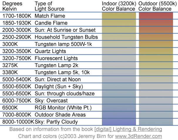

By the twisty bulbs, do you mean the curly low energy ones. Well some of these are OK (ish) . What you need top know is the CRI index. CRI refers to the Colour Rendition Index. The higher the number the nearer to daylight it is. Daylight is 100. Probably anything around 90% should be OK. Anything less than this may give unacceptable results.
Here's a table showing the various colour temperatures
so if you get the temperature of the bulb you can see where the light output falls - as long as all the lighting is the same you can make adjustments to the white balance on the camera to get the correct colours .
