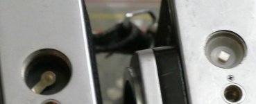

Just had a quick look.
The Spotmatic F I have an AG12 in, it is the one in the picture with the black plastic battery holder.
The other Spotmatics I have AG3s with O rings.
The ordinary Spotmatics (ie not the F) have the white plastic battery holder, which from the badly out of focus photo you can see it has a taper at the bottom, which prevents the AG12 from fitting.

My recently acquired Spotmatic has the same battery chamber as the white one you have pictured here and it took me quite a while to find a suitable battery; no one on the Pentax Forum recognised it. Help came in the shape of Cameratiks in Edinburgh who recommended the Energiser 392. It looks absurdly small for the chamber, but doesn’t rattle around once the lid is on and appears to work fine.
