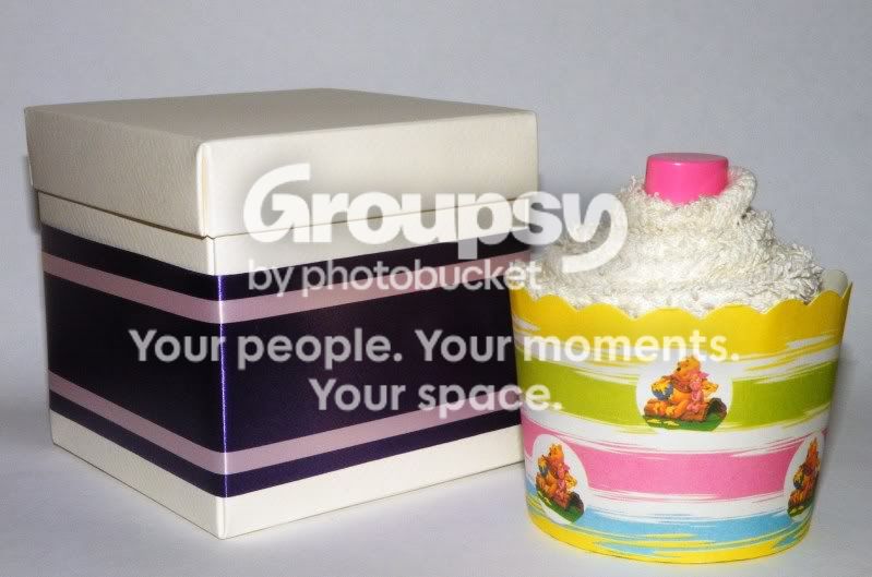

I currently have a 30inch light tent bought from eBay years ago.Picture below
I have had some ok results by placing it on a footstool right in front of a window but this is not really a long term solution.

here are some photos i created from my light tent with just daylight.
The last one was helped along with some editing software but i really struggled to get a pure white background.
I also experimented with a black background but they did not come out too great.
Will i get better results than them pictures by using a DIY set up?

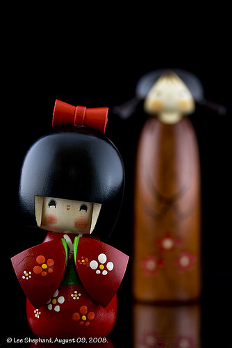

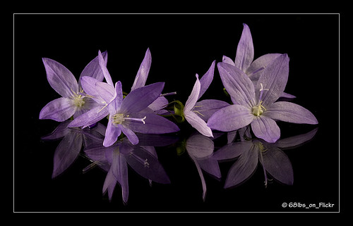

One last thing for this absolutely monster essay like post,how can i get results like in this auction.
http://cgi.ebay.co.uk/Black-White-S...6:3|39:1|72:1690|240:1318|301:1|293:1|294:100
Can i se some sort of perspex or something like that to create reflexions instead of shelling out £25 on something if i can make it for cheaper.
I think using a black surface like this will help alot with light coloured objects.

For the reflective base, get hold of an old clipframe (those A4 glass sheet/hardboard sandwich things) and use the glass as the base under your object.

I found a black backgroud was easiest for flebay type shots. Bit of glass sat on black card inside the light tent with a black back to the tent...
