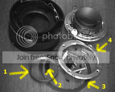

Heres the pic:
which one is an interior plastic ring?
if i removed it, will it still work for EF as well?
thanks!
None of the numbered ones, it's the inner circle on the black housing top left. Still works with the EF lenses :thumbs:
