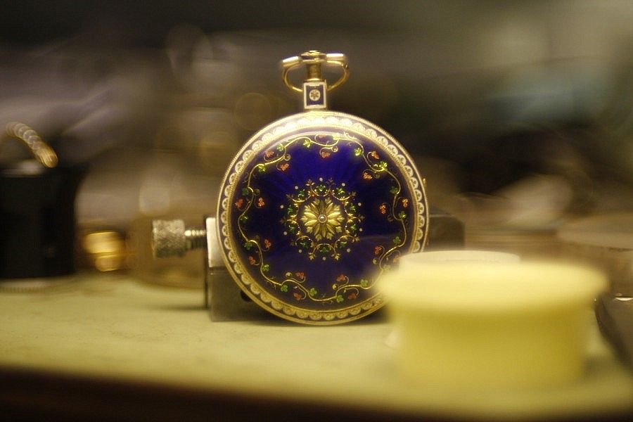

I have a few FD lenses from when I used to use an AE-1 I inherited from my dad who was a keen photographer. They rarely get used now but having come across "The Lens Doctor's" adapter I thought I'd give them a go, especially as they are possibly better in some respects than my EF lenses. It came today but I've had to wait till tonight to give it a go - Just focused on a watch on my work bench.
First lens: 50mm F1:4 Canon.
This is at F2
At F1.4 it seems to go a bit soft. Don't know if that's down to the lens itself or possibly because thats as wide as the adapter itself? Will be interesting to try it in proper light as I quite like the dreamy softness is some ways.

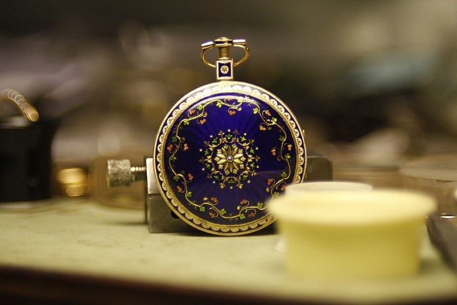

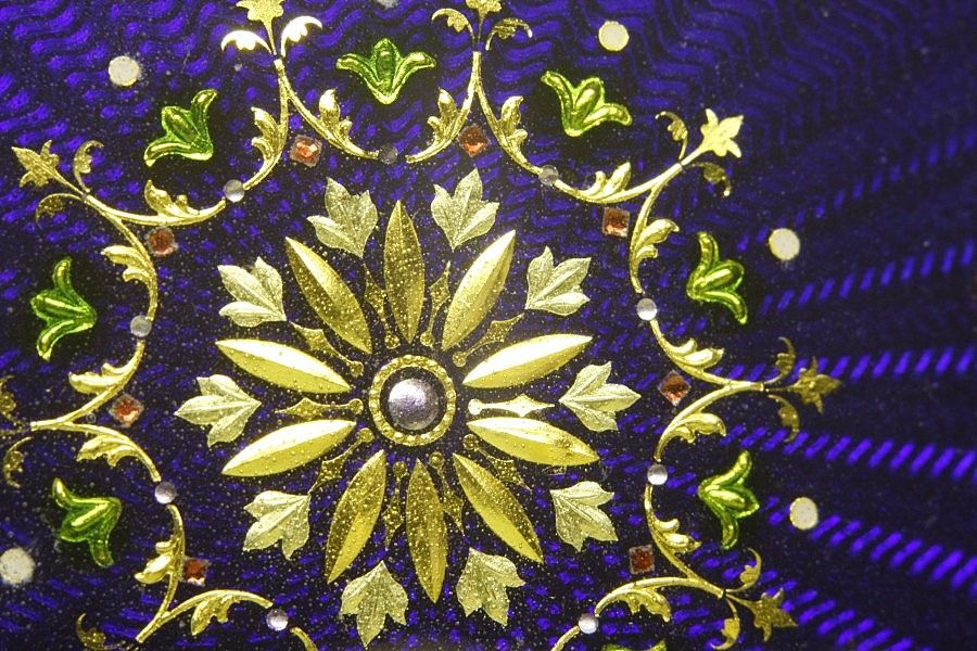

Next lens is a Vivitar 90mm F2.8 macro. I think this was at F5

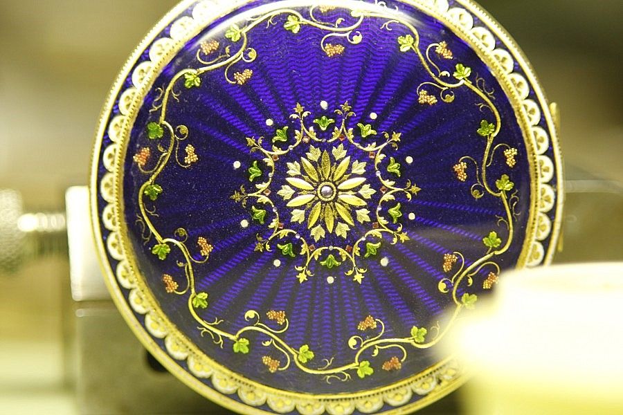

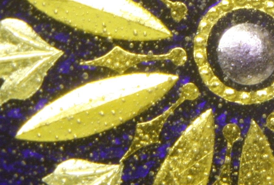

Zoomed right in and F11.
The specs are not dirt or dust but bubbles in the enamel. Impossible to see with the naked eye. This is a 100% crop
The adapter includes electronics to utilise the cameras focus confirm but I found that for these I got better results using the live view. Perhaps on larger objects the focus confirm will prove more worthwhile.

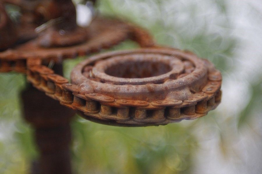

Back on with the 50mm. F2 is really nice.
but I don't think I can realistically use F1.4 I'll see if I can find out why.

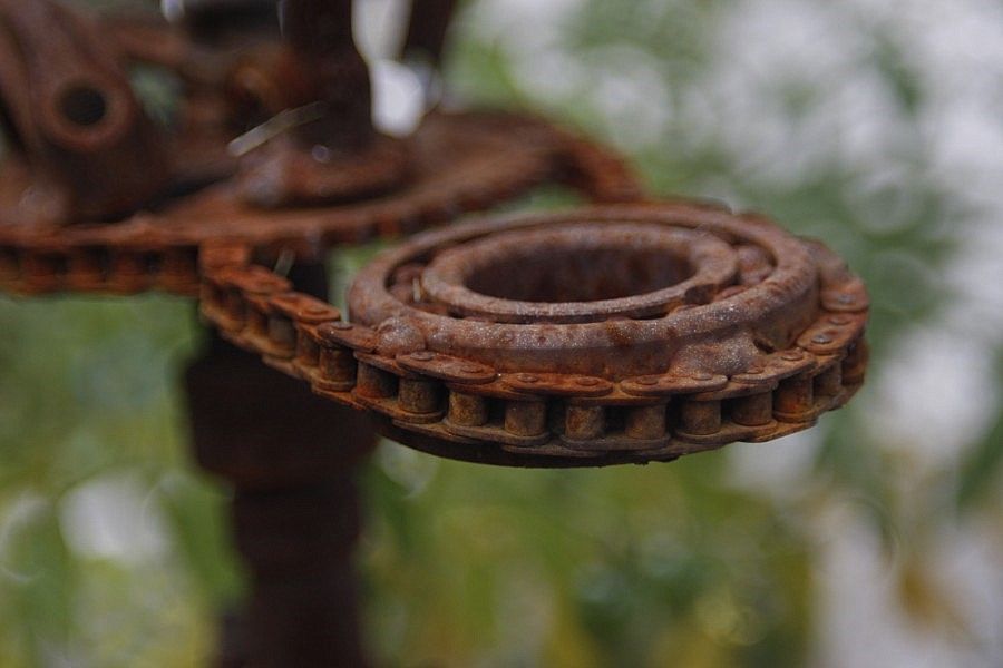

Back to F2
They look ok but whether they would have a lot of mileage i guess depends on price etc.
The lens at f1.4 looks not far off a soft focus lens. Would be interesting to see a few portraits with the lens at that DOF.
