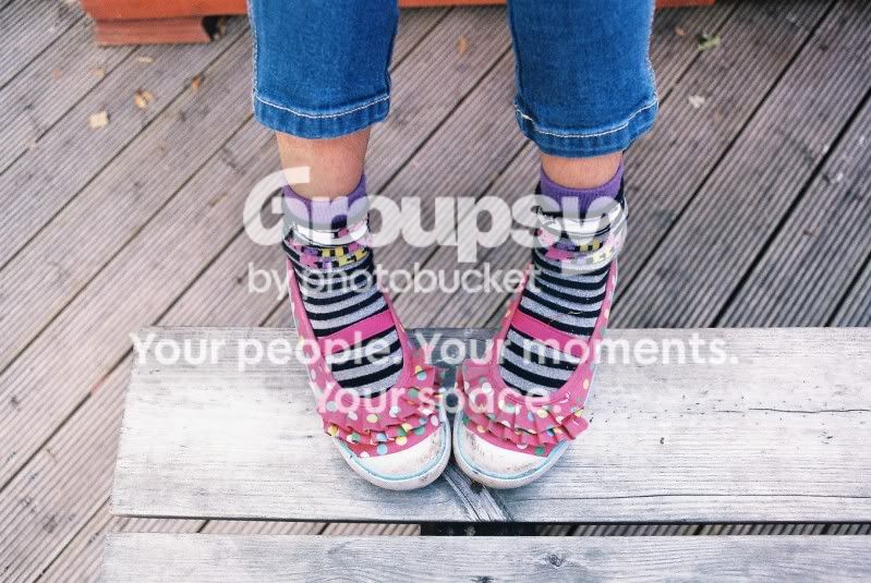

Not so sharp from Hexar:

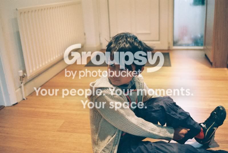

Sharp from OM4:
Actually, looking at them on the web and the Hexar one doesn't look so soft, maybe this is an issue of scanning?

Here you show one interior photograph (the ligh would not be so good) vs exterior photograph. Maybe you were using low speeds on the Hexar and you got some grain too... But when I see better the boy's jacket is really sharp on the arm closer to "us"...
